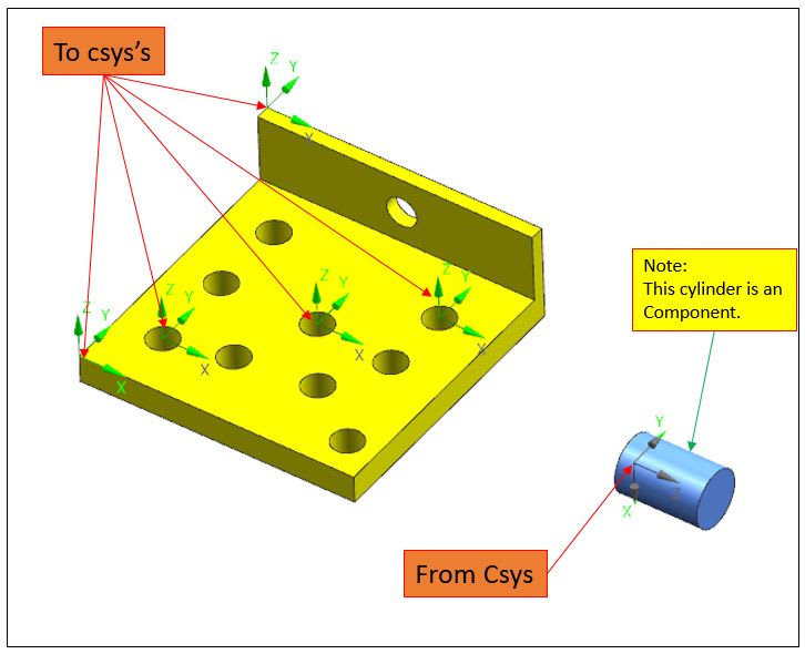

I would like to copy a component from single csys to multiple csys in Nx Assembly part.
I got most of the code from cowski's replies. He wrote code for move a component from one csys to another csys's.
But my requirement is I need to copy component from one csys to n number of csys's.

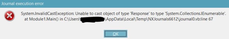

so I had modified that code with "SelectTaggedObjects" method. but I missed something else. so It's shows
"System.InvalidCastException" error. I tried in all ways. But I can't able to figure out the issue.
Modified code and Error image attached below.
While run the below Journal,
Step 1)user going to select csys of component(From csys).
Step 2)user going to select destination csys's (Here user can select multiple Csys's of Nx Assembly)
Result : selected component placed in all csys's ,which I selected in step 2.
Above step 1 & 2 are worked But After journal Execution the component not placed in csys's. Journal window shows "System.InvalidCastException" error)
Error image Attached below vb code.
It would be great , if someone help with this.

        Dim obj As NXOpen.TaggedObject
        'Dim selectedObjects1 As TaggedObject() = SelectmultipleCsys(toCsys)
        For Each obj In SelectmultipleCsys(toCsys)

    Function SelectmultipleCsys(ByRef selObj As TaggedObject)
        Dim theSession As NXOpen.Session = NXOpen.Session.GetSession()
        Dim workPart As NXOpen.Part = theSession.Parts.Work
        Dim displayPart As NXOpen.Part = theSession.Parts.Display
        Dim ui As UI = ui.GetUI
        Dim message As String = "Select the faces to assign the surface finish"
        Dim title As String = "Select a Coordinate systems"
        Dim resp As Selection.Response
        Dim includeFeatures As Boolean = False
        Dim keepHighlighted As Boolean = False
        Dim selAction As Selection.SelectionAction = Selection.SelectionAction.ClearAndEnableSpecific
        'Dim cursor As Point3d
        Dim scope As Selection.SelectionScope = Selection.SelectionScope.AnyInAssembly
        Dim selectedObjects As TaggedObject() = Nothing
        Dim selectionMask_array(0) As Selection.MaskTriple
        With selectionMask_array(0)
            .Type = UFConstants.UF_coordinate_system_type
            .Subtype = UFConstants.UF_all_subtype
        End With
        ''Dim resp As Selection.Response = theUI.SelectionManager.SelectTaggedObject(prompt, _
        ' title, scope, selAction, _
        ' includeFeatures, keepHighlighted, selectionMask_array, _
        ' selObj, cursor)
        resp = ui.SelectionManager.SelectTaggedObjects(message, title, scope, selAction, includeFeatures, keepHighlighted, selectionMask_array, selectedObjects)
        If resp = Selection.Response.ObjectSelected OrElse resp = Selection.Response.ObjectSelectedByName Then
            Return Selection.Response.Ok
        Else
            Return Selection.Response.Cancel
        End If
        'Return selectedObjects
    End Function
