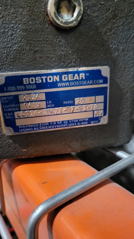

Let me add some info to this. So we have about 200 work orders out of them 44% are gear reducers that are leaking. Either from the outlet shaft or inlet shaft or from the posivent fitting. Why would so many be leaking. Also we do conveyance like v-belts accuglides and belted conveyors. Is it wrong size over filled under filled to much tension or misaligned
460 centistokes is about as thick as gear oils get so that is going to cause it to run hotter. I doubt an incorrect oil specification would increase the temperature much beyond that.
But! It's ok for gearboxes to run hot with the right seals. If it's too hot to touch by hand that just means it's above 150°F. Gearboxes will easily tolerate temperatures up to 250°F but will require special seals to do so for continuous operation. What seal material was specified for your gearbox? Viton and silicone are superior at high temps but don't have good wear properties. Engine manufacturers use PTFE seals as their operating temperatures are normally 210°F. Viton and silicone will tolerate those temps as well but lack wear resistance.
That's a worm-gear reducer. They have terrible efficiency. They run hot. Still ... they shouldn't leak.
Call Boston Gear and ask for technical support.
Like Mintjulep suggested - have you contacted the manufacturer? They know their product, and the most common problems, better than anyone. They also have a staff of full time application engineers whose only job is to help you succeed with their product. Of course you want to download any information, but you also want to speak to a live human being. I feel safe in saying there is nothing wrong with the gearboxes, and probably nothing wrong with the way they are installed. I'm very confident the problem lies in how they have been maintained.
