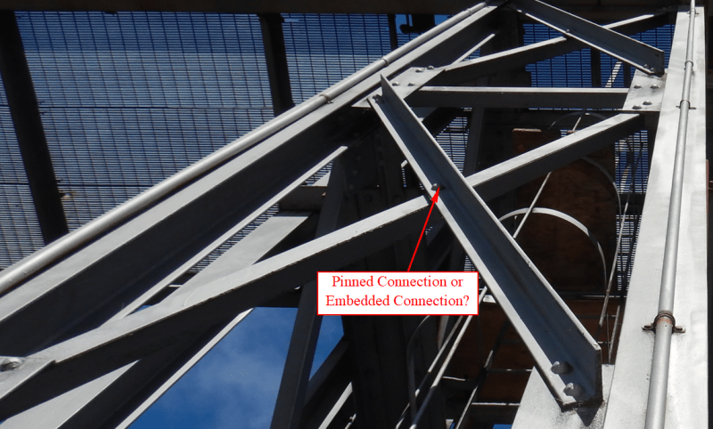

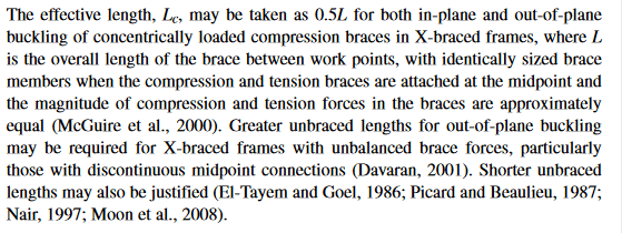

What is the use of a middle rivet in a X bracing? Is it used to reduce the K*L/r ratio? I am asking this because the K*L/r ratio of this bracing is too high (255) if I don't consider the rivet in the middle. I am evaluating this existing structure. It would be odd that the designers at the time (year 1920) would have designed a structure with a K*L/r ratio over 200.
However, I don't see how the middle rivet can really help to support laterally the bracing in compression against buckling perpendicular to the plane of the bracings in X.
If you are concerned with bracing the compression diagonal with the tension diagonal, AISC added the following to the Commentary of Appendix 7 in the 2016 Spec. (p. 16.1-569 available for free: PDF page 627). One of the references is that which KootK provided, but there are several others provided as well as some acceptable conditions for a 0.5 value.

I guess I'm not familiar with the term "total bracing capacity". In T-Line towers, each of the diagonal bracing's capacities are given in ASCE 10 for tension, compression, bolt shear, and bolt bearing. The actual load is compared to the limiting capacity. Let's assume the diagonals have 10k in ten and comp actual load. In this case the tension brace has more than 20% of the 10k load in the compression brace and you can count on the center bolt for out of plane support and Lz is 0.5L when you compute the compression allowable.
If the tension diagonal has less than 20% of the comp diag load (in my example 2k) then the Lz is 1.0L. I have seen some people use 75% of L and count the center bolt as a partial brace, no matter how small the tension load is.

I just reviewed ASCE 10, it states the following:
"If the member in tension has a force of not less than 20% of the force in the compression member, the crossover point provides support resisting out-of-plane buckling."
As far as I can find this is only stated in example calculations - it is not mentioned in the body of the standard.

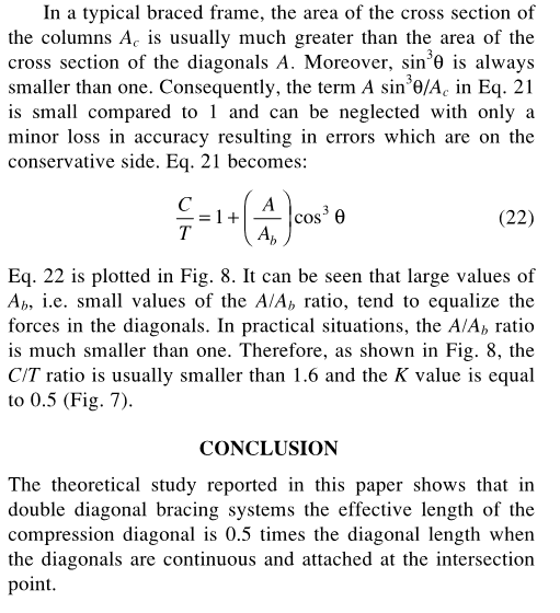

thanks for the response guys
i found this article... seems to be okish
if anyone interested
and this
also
from
website said:
The result of alternating between tension
yielding and compression buckling of the bracing leads to
deteriorating and pinched hysteretic behavior in
compression cycles, which is the main characteristic of
TOBFs. According to seismic provisions of AISC 341-10
(AISC 2010), the use of tension-only bracing is not
permitted as special concentrically braced frames (SCBF)
and it is only permitted as ordinary concentrically braced
frames (OCBF). In the active seismic areas, using the TOBF
system is not recommended in medium and high-rise
buildings (Filiatrault et al. 1998).

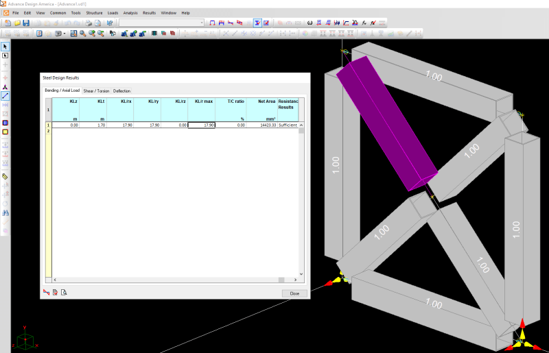

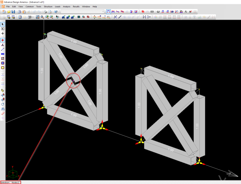

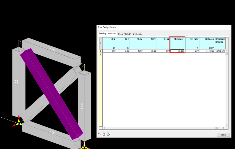

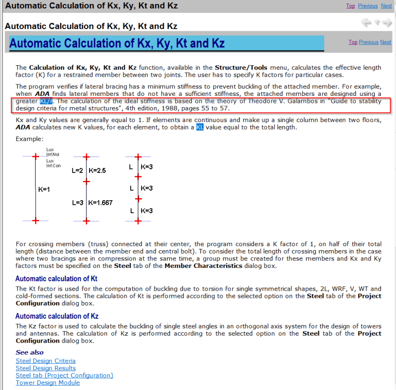

wrxsti said:
why doesn't FEM software pick that up?
risa3d has 4 settings for any given member: "both ways" (tension and compression), tension only, compression only, and Euler Buckling. I'm not sure if this is exactly what you're talking about but it will only allow the member designated as "Euler buckling" to attract as much load as the calculated buckling load. I've never used them but that's my understanding of how it works.
