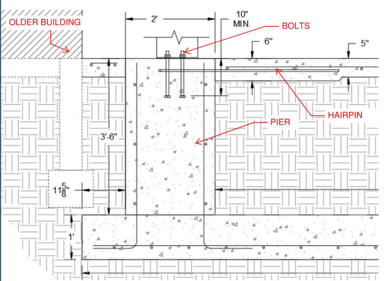

Hi All, I'm looking from ideas/input on this issue. I'm on a project where the contractor forgot to place the rebar hairpins at the top of the concrete columns for a per-engineered steel building. The error wasn't discovered until months after the building was complete and photos of construction were being reviewed for record drawings. Per design, the hairpins were to prevent break out of the bolts. As it currently sits, the capacity of the bolt connection is under capacity by 4kips, breakout is the failure mode.
On one side of the building, the foundation was poured against another per-engineered steel building foundation so the top of the piers are restrained by the foundation/slab of the adjacent building. Would this potentially prevent bolt breakout as the concrete between the bolts and edge of pier is unable to move laterally due to the adjacent building?
On the opposite side, the piers are not restrained by an adjacent building. Could a steel plate/beam or whatever is needed to resist the breakout force be placed across the outside face of the concrete pier to restrain breakout failure? Does concrete breakout function linearly or would breakout occur and push up?

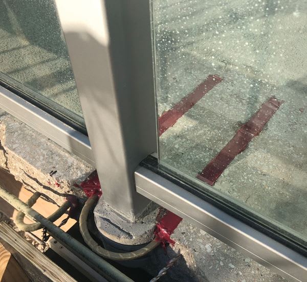

See attached link to an article in Structure Mag.
The author details how hairpins were added to support a balcony railing post. That's much smaller scale than your issue, but I think the concepts are the same.

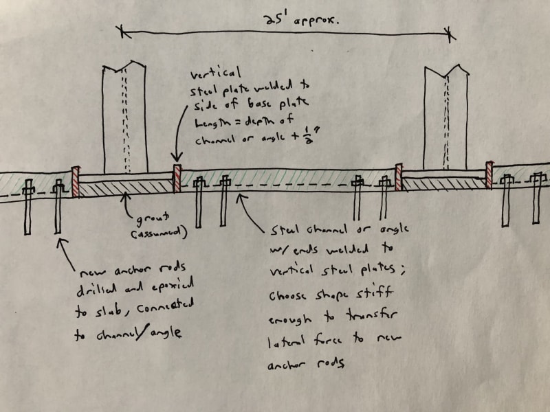

Not sure if this works for your particular application, but here's an idea:
Basically, run a steel shape between the base plates. I figure a channel or angle probably works best. The lateral force from the columns will be transferred into the steel shape which will be attached to the concrete with anchor rods drilled and epoxied. You'll want to choose a steel shape stiff enough to transfer that force to the new anchor bolts which are located furthest from the column. If you only need 2 or 3 new anchors at each end, a relatively small shape should work.
Modifications on this idea might also work, like extending wings off the base plate or column to provide more anchor locations, without extending the shape all the way between columns.

You are correct, it's a pedestal sitting on spread footings. Below is some sections details of the pier next to the original building and the opposite side. Also, below is a plan view of how the piers are set with regards to perimeter stem wall.

The pedestal does have ties. If I recall correctly, edge distance is around 8-9inches. I'll have to verify when I'm back in the office. Shear varies with frame line but max is around 22kips.
8 to 9 inches is a decent amount, maybe there is a way to make the concrete edge distance work, however with anything over about 10 kips, you are normally hard pressed to get hairpins to work, normally at 22 kips you would have needed tie beams. Not saying you can't make hairpins work, but at 25' o.c. the influence areas overlap before you grab enough concrete typically to resist due to friction/weight.
16kips is what I can get out of the edge distance. Hairpins were to supplement to rest.
Dedicated anchor reinforcement should be designed for the full 22 kip shear load, not the net load after subtracting the breakout capacity.
