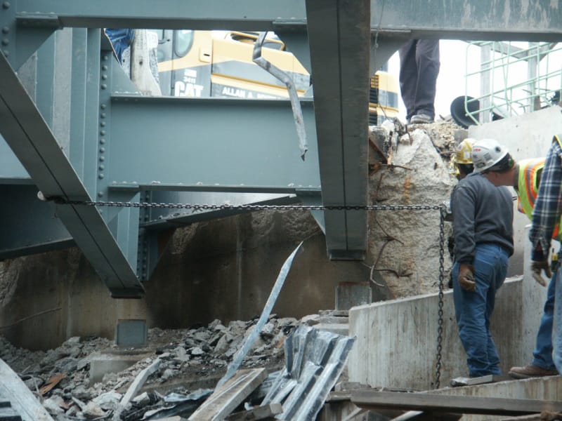

It's a re-decking project for an existing continuous, 4-span steel bridge being done in two stages (Stage 1: Northbound Lanes, Stage 2: Southbound Lanes) with a longitudinal joint in between. The contract plans have a deck pour sequence that shows the positive moment regions being poured before the negative moment regions.
On paper, the contractor's RFI requested to do a continuous pour for each stage. So the obvious, short answer was, "No."
In conversation, the contractor claims to have used a concrete retarder for continuous pours on similar projects.
Does anyone know if any studies / reports (FHWA, NCHRP, ACI, etc.) exist, regarding the use of retarders for crack control in continuous concrete deck pours?
