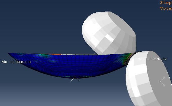

How can I solve this warning in ABAQUS?
For a self contact surface, the facets of the elements in element set WarnElemFacetThickPt63d-Step1 are thicker than 0.6 times an edge or diagonal length of the facets. Use the MAXRATIO parameter on *SURFACE to allow automatic rescaling of the contact thicknesses where necessary for this surface. Refer to the status file for further details.
Start by following the suggestion given in this warning message - add the MAX RATIO parameter to the *Surface keyword corresponding to the definition of the surface included in self-contact.
@FEA way The contact is General contact and there is no self contact, as you can see in Picture.
Most likely this error will disappear when you change the mesh size so that it matches shell thickness (currently thickness is too large when compared with element edge length).
