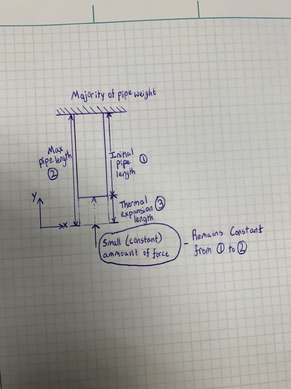

I am working on a project to support a large pipe during thermal expansion. Most of the weight will be supported from the top, but a constant portion of the weight needs to be supported from the bottom to minimize permanent thermal expansion without causing a buckle at the top. I originally thought about using a constant spring and that still is likely the best option, but they are expensive and bulky. My next thought is to use hydraulic/pneumatic cylinders with some type of valve. I am still a student so I am pretty new to engineering design and have not worked with hydraulic and pneumatic cylinders much so I am wondering if this would be a possible solution or if these cylinders are commonly used for this purpose. If anyone has any other recommendations, please share if you'd like to.

I think this setup is simple enough to do by hand and without CAD since I am looking for somewhat general concept advice rather than something specific to my project. I have attached both PDF and PNG files just in case. Let me know if there are any viewing issues.

The pipe would buckle from too much bottom support, not top support, sorry.

The pipe will provide an initial expansion of .15m which is elastic and then a maximum plastic elongation of about .35m that occurs throughout the life of the pipe. The top support of the pipe holds around 3/4 of the pipe weight, while the bottom holds the other 1/4. These statistics should remain constant and there should be no transition of weight from the top support to the bottom during therm elongation.
The space below the pipe would allow for a const spring support but it would block the walkway.
The bottom tube support will be around 1 ton for reference.

A little more detail would help here. What is the pipeline size? Design/Operating Temp & Pressure? Material? Etc. What amount of growth are you anticipating?
Depending on the line size, adding an extra bend or two to the line may be more economical than a spring support. That said, IME spring supports are not terribly cost prohibitive when used appropriately.
As far as hydraulic supports go, they do exist and are known as snubbers. Their purpose typically is to absorb rapid expansion in cases of steam/water hammer or seismic event and not act as a constant load support.
