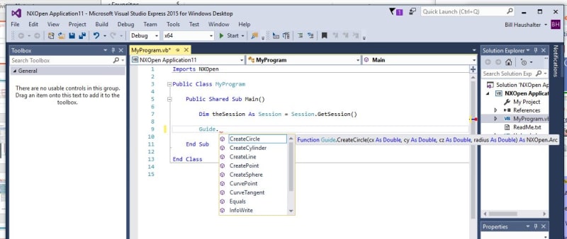

You can install the free version of Visual studio express and edit your code outside of NX. You have to install the NX templates but as an added benefit it will give you auto-suggestions while typing code. No sure if you can have it autorun from NX.
