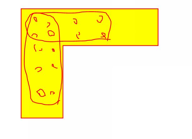

Hell yeah it would be nice. It's actually been a longstanding dream of mine to create such a guide myself. The trick is that I'd get lambasted six ways from Sunday on every aspect from engineers disagreeing with me. I figure it would have to be sort of a "survey of common practice and pertinent issues" rather than "design your walls like this jackasses.". You know, in the interests of diplomacy and book sales. Wouldn't want to screw my publisher in the insanely unlikely event that I actually found one.
I used to tear my hair out wondering at the particular form of zones like this. How much bar goes in which wall? How do you design the stirrups for longitudinal shear to be able to properly engage the bars in the other wall? What about bi-axial bending of the core? What about closed shaft torsion? Arghh... the complexity!!
Turns out most of these will just be overlapping linear wall designs and nothing a lick fancier than that. To a degree, I believe that even a compound wall, ETABS design will be handled tin a similar fashion.

Correct me if I am wrong KootK, but I believe in this process the analysis considers the core's total stiffness, but design each face of the core for the load it experiences.
Nope, modeled with boxes literally broken up into line segments with no vertical shear connection between them. I know... that's what makes it so shocking.
