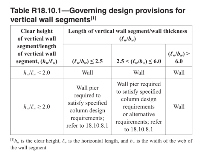

Regarding concrete walls, I referred back to ACI and found this table for Special Walls. Now my question here, would you apply this table as a general guideline for walls that are not required to be special (i.e., ordinary). The lateral load in question is purely wind driven and seismic is no where near a concern (SDC A).
Seems like all the limitation of this table refer the designer to an alternate provision for something design as a 'Special Wall'. Once a wall segment ratio classifies as a wall pier, it must satisfy the special moment frame requirements for column.
I'm not that familiar with ACI, but the table that you provided looks to me like the one making a distinction between slender and squat walls, i.e. how you need to design the pier itself. It has little to do with the frame vs cantilever action and more to do with shear force - bending moment interaction.
