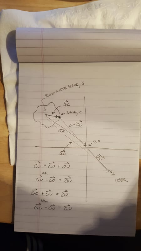

[li]for some angles two solutions will exist because the curve has shifted fully into a quadrant, for these I need to determine some way to do a change of reference on the solution angle so instead of referencing the P,Mx,My origin for angle measurement I need to instead use a coordinate inside the Mx v My slice This is where I'm currently stuck.[/li]
[/ul]
Another option I think may solve both my problems is finding the two peak nominal points and connect them with a straight line and call this the new Z axis then working out the 3D coordinate transformation required to align this new Z' axis with the original Z(axial) axis this should eliminate the two root possibility. I am slowly trying to learn the 3D transformation stuff to attempt this.

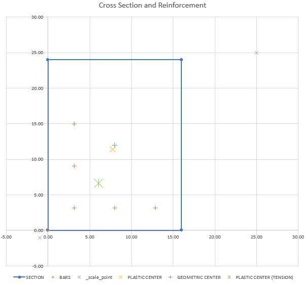

Section and Reinf. (F'c = 5 ksi, 16x24 in, all bars are #8's)

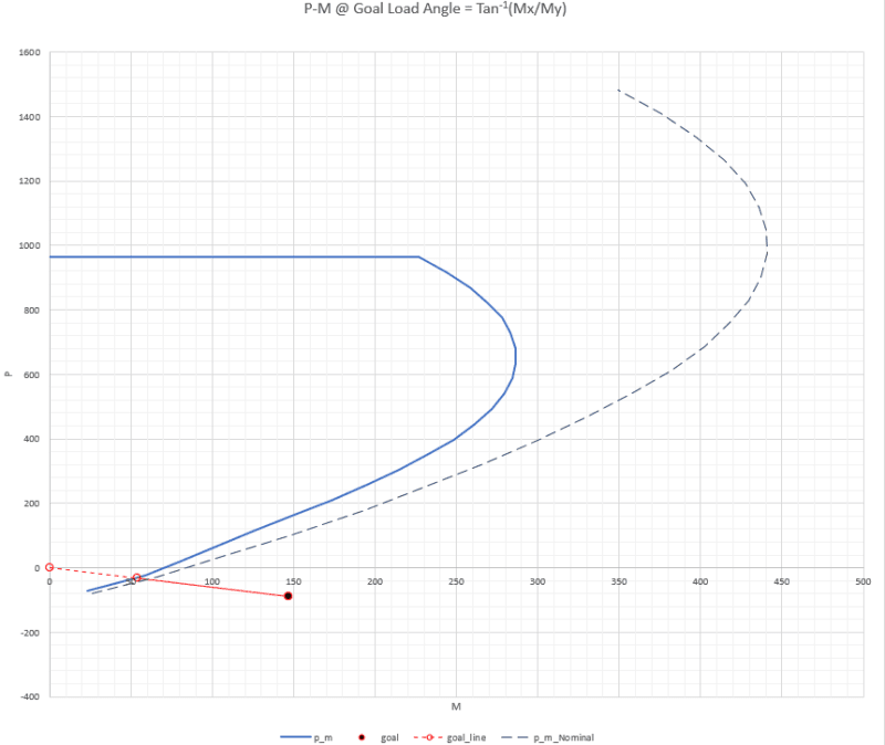

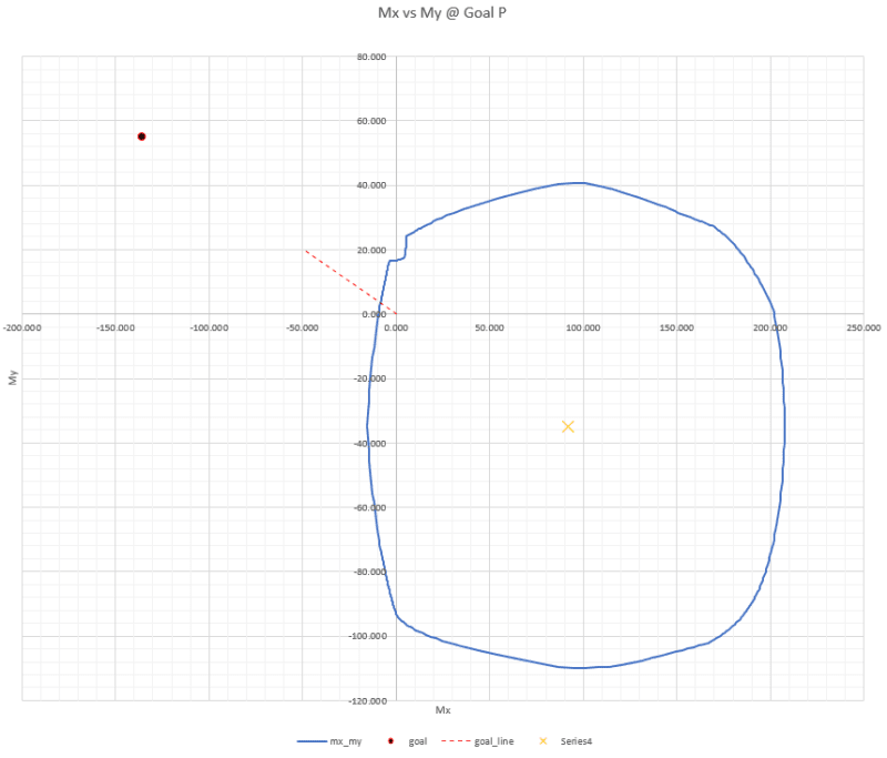

First hurdle curve close to the P axis:
Mx v My slice @ P = -90 kips: Notice curve almost entirely skewed
P-M Slice at Tan -1(My/Mx) = 2.7572 radians

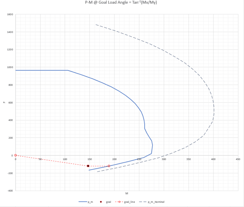

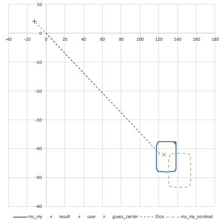

Second Issue Mx My slice completely shifted
Mx v My slice @ P = -120 kips: Notice curve entirely skewed now
P-M Slice at Tan -1(My/Mx) = -0.384 radians: note curve should actually reach a low point and then have two solutions at most -P's

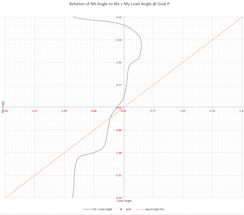

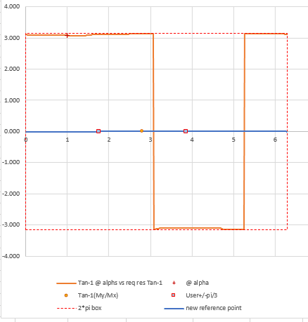

Relationship of the Neutral Axis Angle to the tan -1(My/Mx) load angle at P=-120kips:
This is the chart that best shows that no solution exists for certain load angles

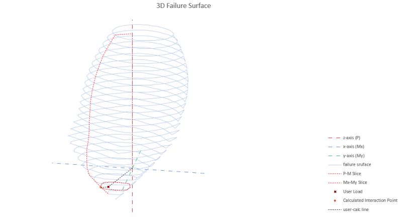

3D Interaction Surface with the Mx/My slice and P-M curve in case it makes the visualization of the problem easier:

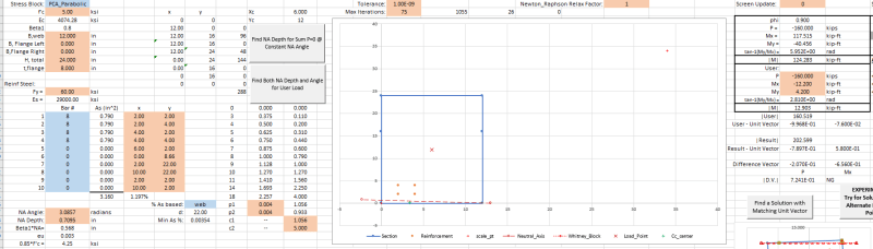

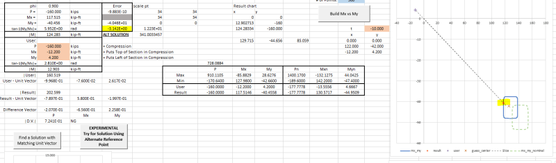

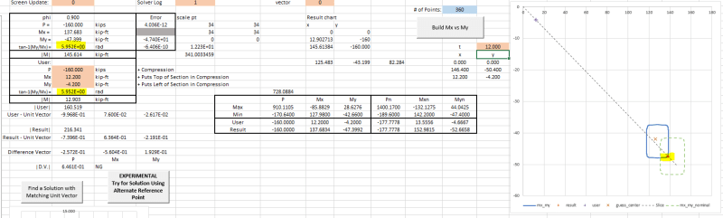

Spreadsheet - Macro Enabled and Required: (link for the curious)
This is very much a work in progress so feel free to ask questions on deciphering what is going on where.
