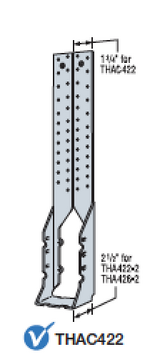

I might spec a THAC hanger so I can fold it over the top of the beam (11 7/8" LVL's).

For me, I would typically only use a connection like this as a last resort. Even then, I might try to use a top flange hanger instead (if they make such a thing which doesn't project beyond the end of beam). The THAC422 noted above is probably a better solution.
Hence why I am going to use a THAC truss hanger so I can fold the straps up and over the carrying member.

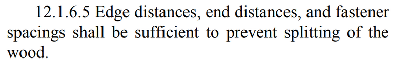

Those tables aren't applicable to nails and wood screws (assuming diameter < 1/4").
Section 12.1.6.5: Edge distances, end distances, and fastener spacings shall be sufficient to prevent splitting of the wood.
True, the code does state that, but then fails to provide any distances for these things. Kind of like saying: "Beam to safely resist all required loads." The code commentary does however provide some good guidance. For this particular case (per OPs question), though, I don't think the commentary addresses end distance with loading perp to grain.
