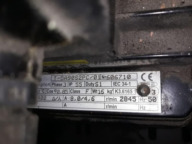

I have been given a 3 phase compressor for home,looking at the wiring
on the motor is it possible to wire the motor to single phase for home
use UK 240 Volts
Many thanks dan

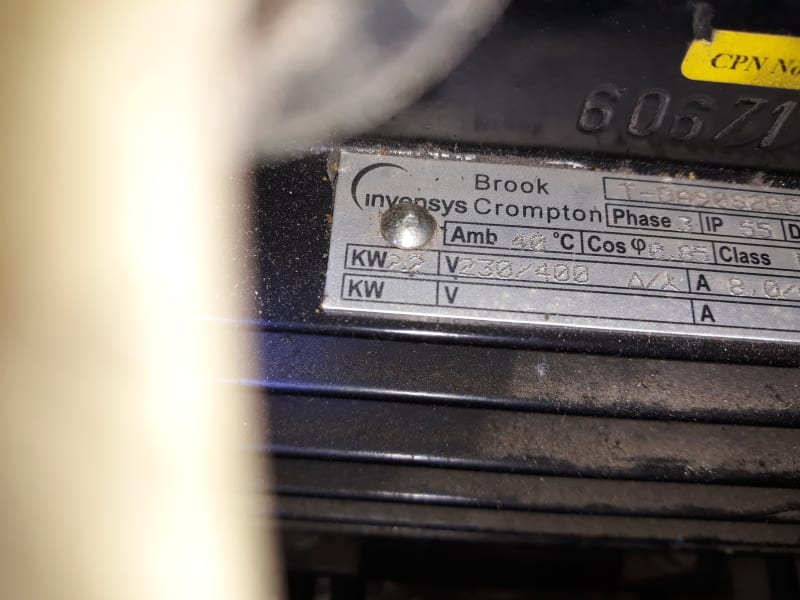

What gets me is the the motor tag says 230/400v ?
original motor on compressor speed 2845 rpm
can anyone enlighten me on the 230/400v
Many Thanks
There's two legitimate ways you can fit the links in the terminal box, and they configure the motor windings in two different ways. If you look at the rating plate again, that box doesn't just just say 230/400 - it also contains a pair of symbols. What that's saying is that you can run the motor on a 230V (phase to phase) supply if you connect the windings in Delta formation, or on a 400V (phase to phase) supply if you connect them in Star.
From your very first photo, your motor is currently configured in Star - (for Delta, you'd see three links running left-right, rather than two running top-bottom like you've got)- which is as you'd expect if it had previously been run on a 3 phase LV supply in the UK.
In a way, you're right about being able to move the links to make it run on 240V - but it would have to be three-phase 240V measured phase to phase, and that's not a supply you will find a lot of and certainly not the one you had in mind.
