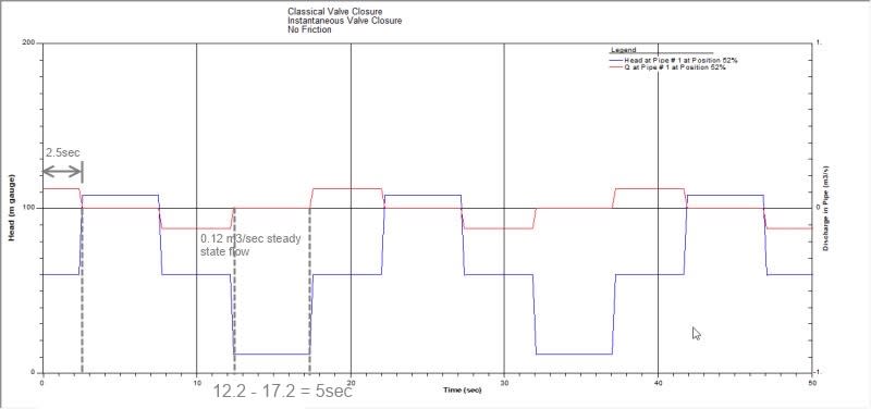

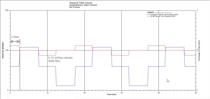

I have modeled a simple system of single pipe. The upstream is connected to a water reservoir RL(m)=80 & pipe RL(m)=20, Dia(m)=0.6 & Length(m)=5500. The downstream (end connection) is a shut-off valve discharging to atmosphere @ 0.12m^3/s. This valve is simulated to close at 0.01s abruptly
Now I have x2 graphs from which I need to comprehend:
1] Wave reflection time 2L/c ...more about this parameter: 2] System deceleration value
Now please audit if my comprehension is correct
From the 1st plot 2L/c = ~19.5s
so c = (2*5500)/19.5 = 564m/s
From 2nd plot system deceleration is
0.12/(0.25*pi*0.6^2) = 0.424m/s
0.424/2.5 = 0.17m/s^2
I'm not sure what you're doing there.
sonic velocity in water is around 1450m/s, not 564.

ax1e, thanks for your input I had discovered my mistake. 19.5sec, time duration of complete wavelength (if you put it that way) equals 4L/c
From the 1st plot 4L/c = 19.5s
so c = (4*5500)/19.5 = 1128.2m/s
ax1e, you previously said you are versed with transient software. So how do you estimate system deceleration from the plots? Any method of calculating it?
1128m/s is still quite a bit slow.
Why not L/c?
I don't really know what you mean by "system deceleration".

Low speed because plots are generated by HYTRAN which was set-up to include 1% air as well as pipe elasticity is also included...
ax1e said:
Why not L/c?
we will do it your way. If you see the diagram at bottom right of You can say that at L/c v=0; that means Q=0. This value can be observed via 2nd plot
You can observe from graph it's ~5sec from 1st plot it was ~4.875sec

I need this value to study & select check valves as mentioned here
In accordance with what I have said previously, when I do a transient analysis, I have to enter a check valve closing time. However flapper closure really occurs over the same period that it takes the reverse flow to move the same distance that the flapper has to move to reach closure. It is the reverse flow rate associated from the pressure wave that forces the flapper to move to the closed poosition, therefore clossure can not occur slower or faster than the reverse flowrate. you might also assume that the surge pressure acts on the flapper and closes it, so you could do a acceleration = force / mass to find the average acceleration on the flapper and solve for velocity and distance traveled during the time period. ?? I have never found it necessary to do anything other than enter the valve closing time.
IMO when the check valve closes, flow has stopped and you essentially have complete deceleration except for some residual waves that only travel back and forth, which I think with isothermal flow and no friction will never stop, however net deceleration (no sustained flow forward or backward) has already completed.
Look at the chart, find the kind of check valve you need for your given flowrate use its closing the time as the deceleration period. Maybe you need to use an iterative solution to find out the answer you're looking for.
