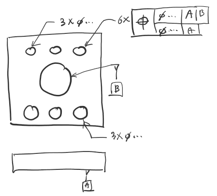

Size of upper three holes and size of lower three holes are different. Composite position FCF is attached to one of the six holes with "6 X". Doesn't this make sense, without a note like "INDICATED"?
2022-10-19_13_11_52-WOOSANG%EC%9D%98_%EC%A0%84%EC%9E%90_%ED%95%84%EA%B8%B0%EC%9E%A5_-_OneNote_for_Windows_10_k5a6qx.png
Woosang,
It makes sense, as long as the only hole not included in the pattern is the datum hole. If you have other holes on the part then the question is "which 6?".
