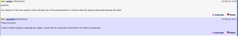

greenimi,
Yes, adding D in the lower position callout will take care of the perpendicularity. It will also refine the spacing relationship between the studs.
Thank you pmarc,
I have no futher questions regarding this subject. (unless the OP would add or has his/her own follow up questions).
