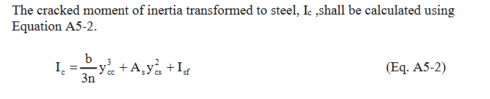

SDI C-2017 (Calculation of Id found on page 41-43)

Talked to Vulcraft. Apparently, need to be using E steel and not E concrete. That explains it.
The calculation referenced by PPE mentions a conversion to steel:
