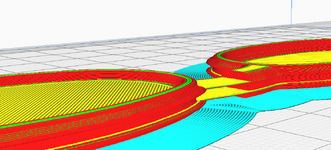

Thank you Cadasio for your reply. Somehow I was able to build a solid with boundary surfaces. It does show up as a solid. I mirrored both the glass border and the half-bridge. Then I used combine to unify it into one element. However after exporting to .stl and opening in Cura, there is a message stating that the part is non-manifold. When I do a construction preview it shows the 1st half of the bridge missing (see picture).
I've had a quick look, and since it's a solid in SolidWorks, then that would suggest its OK as far as geometry goes - though you may want to look at some of the small edges created.
the stl is also fine as I viewed it on https://www.viewstl.com/ and it looked the same.
I have no experience with Cura, but looks like the problem is with that so i would contact them / their forum

I figured out a solution. I rebuilt the bridge as a solid and roughly cut out the lens curve. Then I saved each lens curve as a right & left file. I put all three files into an assembly file with constraints and saved that as a part file. Then I used combine to merge the three solids together.
A very roundabout process, but it works.
