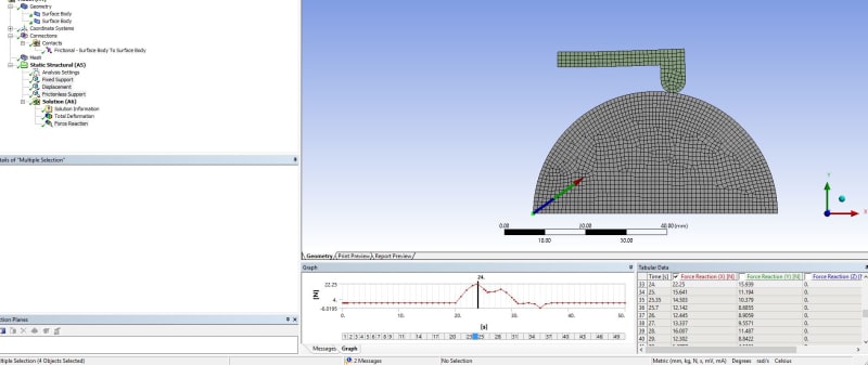

I have a task to check the maximum pressure to push the ball thru. The license I have is only to do a Structural Analysis and not any dynamics. So my question is it possible to push the ball through the apper part using pressure and find out the maximum value for it to pass the restriction. All parts are metal
You can run it static with large deflections on (static, so no dynamics and inertia, which I suppose is fine here), applying an enforced displacement (this can be slowly increased in time) on the side of the ball and pushing it through to the right side.
To get the total load applied, just look on the reaction on the position where the enforced displacement is applied.

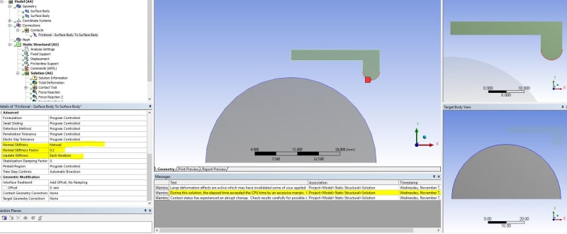

Below is a small example with the enforced displacement and looking at the reaction there on the sphere (sphere slides on a friction-less support) in order to get the force needed to push through (~22 N). Convergence is definitely much easier if we reduce the contact stiffness to say 0.2 instead of 1 (contact settings, and set normal stiffness to manual with a factor of 0.2). make sure that the contact is not going through though. Also material used is steel for both (2D plane strain).

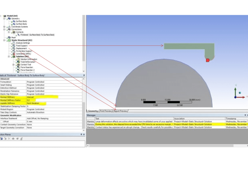

(Below is an image with the contact settings I described in order to aid convergence, hope it helps)
the image is very blurry, cant really see any settings. The upper part is fixed to move uppwards, right? Esspecially the right upper corner of it, so it wont lift when the ball is passing thru. I see you include a APDL command there, could you write what is it?

The upper part (small beam), is fixed on the left side. The half circular part at the bottom is the one that moves from left to right in the positive x-direction (displacement on bottom left vertex). Finally, the base of the half circular part (bottom edge), has a frictionless support.
