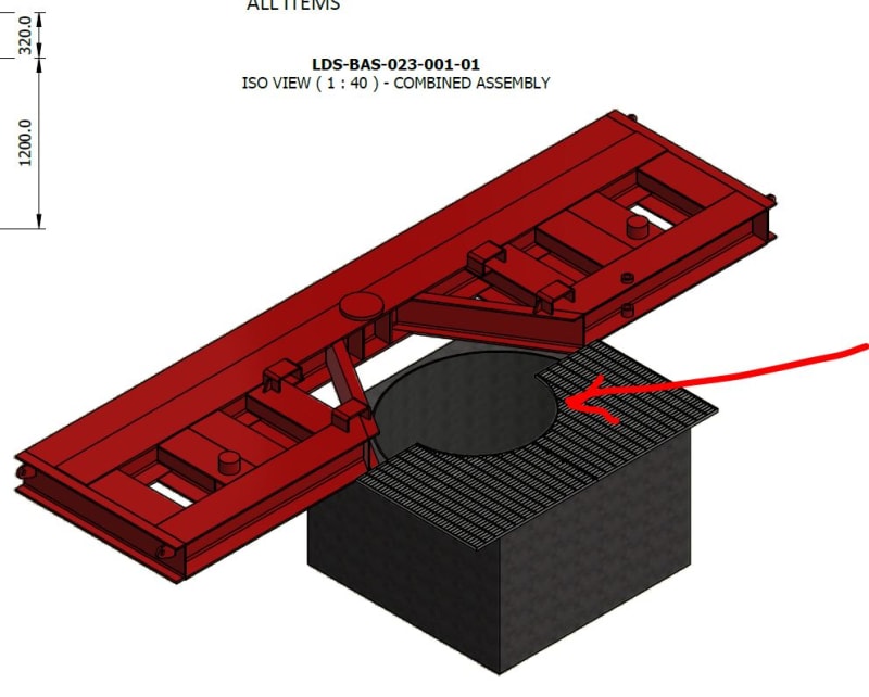

I have a drilling client working out woop woop in Australia. (It's near 'Out to Buggery'.) They will dig a hole some 2.0m x 2.0m and drop a 1800mm diameter casing that is 1200mm deep with an 8mm wall into that hole. They will then backfill and compact against the casing on all sides. (Possibly using a high slump mass concrete mix which is neither here nor there.)
Here's the important bit. They will then place a drilling sub-base immediately adjacent the hole/casing. That sub-base when fully loaded with the drill rig in position will exert a surcharge loading to the soil under of 130kPa.
With a soil friction angle (Ka) of 0.33 I get a lateral pressure to the casing of 43.3kPa due to the surcharge.
Ignoring the soil conditions, whether it was compacted evenly around the circumference , whether the subbase is exerting a UDL is there a formula that you can calculate to work out either the required thickness of the wall required or the collapse load of the casing?
The Roarks formula I have seen here posted previously is for long thin walled tubes. The D/t ratio for this casing exceeds the parameters of the formula they use.
Do I just calculate the hoop stress or is it more involved?
Would someone be kind enough to help? Thanks in advance. (Red arrow points to casing. Floor grating over half of casing.)
The issue I have with this is that your external pressure will vary as you go down - virtually nothing at the surface increasing as you go down, whereas all these calculations assume a fixed pressure all the way along the tube.
Also what is at the end of this tube? Does it just sit on top of some blinding or is it actually pushed into the ground and hence provide some resistance to the external forces. If not why not?
But is this important or just for curiosity? If it bends a bit then so what?
Have they built these and they are collapsing or??
8mm on 1800 though is a D/t of 225. Basically that won't stand any force, especially a point load or over a certain portion of the radius.

If this is a casing to protect people, be conservative. Also note that for something like this although uniform pressure is the ideal scenario, it's more likely to have concentrated type loading in some areas where the compaction is well done and bearing uniformly against the sleeve, and there will be areas where the compaction is inadequate and applying signficantly less pressure. So you won't benefit from the even pressure on all sides.
8mm on 1800mm does seem thin to me as well. On casings of that diameter for sewer work temporary shoring around here they're closer to 19mm thick, and depending on depth of application have regularly spaced stiffener rings.
I have used your 19b formula for vertically installed pipes in soil and water. I see no reason that it cannot be used for a nonuniform distributed load. Design for the unit foot of length that has the highest load, or do the same in each of several load bands of your choice. The problem will be that it will require higher D/t ratios than you might like. A potential problem with the formula, if any, is that it is for an infinitely long cylinder. Nearby edges may reduce the resistance. One way to compensate for close end effect might be to add ring stiffeners at the edges.
Personally I dont believe quality control of the concrete is an issue. I certainly wouldn't lose any sleep over that, as the casing is still in place. Neither is 1200mm depth of all that much concern for personnel entry, unless they are lying flat on their backs. I fail to see any reason to get excited about this.

Maybe try looking at this as though its a buried horizontal pipe, 1.8m deep and you run a large load over the top of it.
If you look at API RP 1102 for casing pipe under roads or look up spangler and Iowa pipeline calculations you'll probably be able to adapt your case to this. Then add a safety factor of your choosing.
CEPA have done a lot of work on crossing of large agricultural vehicles over buried pipelines and there are many online calculators.
You will probably need a thicker pipe.
The only part that I am concerned about is the top edge. Stiffener rings may be the best bet.
There isn't a great way to calibrate how a heavy vertical vehicle load corresponds to lateral earth pressure. In any case that would more likely result in much higher thickness anyway.
Mario, Your answer is probably correct. Its not all that easy to collapse a pipe, even with a high D/t and with full load of 1.2 meters of soil on it. Additionally, what really helps pipe resist external loads, especially a horizontal pipe with a heavy vehicle load above, is actually not just having a small D/t ratio, but how well the pipe is supported by well compacted soil on either side that keeps it from buldging outward at the sides and flattening from the increased "span" of the ever widening and flattening pipe. As the circle becomes a horizontal oval, the "arch" gets ever wider, increasing the span and the resulting with high bending moment in the pipe wall. It eventually caves in as the distance between the side walls increases. If the side walls are prevented from moving apart by well compacted fill on either side, basically the arch will remain strong and it won't collapse until it fails locally at the top of the arch which requires a far greater load to do that.
