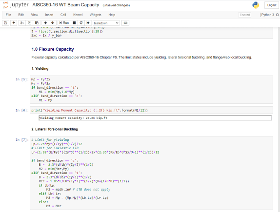

I ran accross this book (Python for Civil and Structural Engineers - and it ignited my interest in the possibility of actually coding all my software tool kit in order to be independent of licensing fees and of compatibility issues (like the ones documented around these forums too) that can result in loss of these assets. It's promising in that, combined with a framework named Jupyter Notebook, it offers a page-format interface that allows for explanation of the process and documentation of the programmed routines, etc, much like you'd be able to do in Mathcad/SMath.

wcfrobert, you should try looking at simplifies jupyter output making it more mathcad like by translating your equations and output to latex output. I've only tinkered with it but certainly takes out some aspects of the making it look like output aspect.
