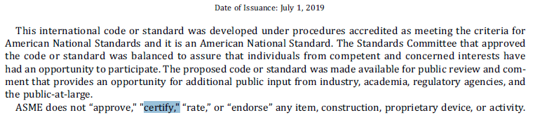

You, as a person, or organization can certify anything. That's what the code says and wants. My point was that ASME itself doesnt certify anything, and that shouldnt be mistaken.
The following can be found in most (if not all) ASME standards:
