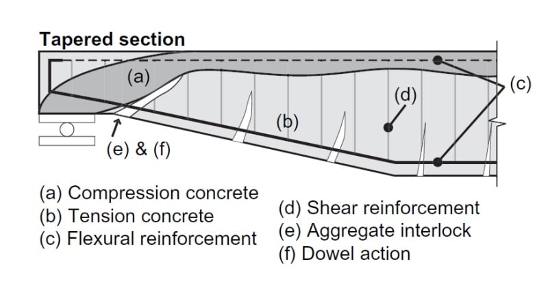

@ALK2415 ,
Where did you find the figure that you have posted ? If the question is , how to analize the beam with variable depth, you can follow the basic principles , just apply equilibrium rules for the section . You may STM model the beam ( truss analogy ) similar to EC shear design concept. Pls look figure C section. The shear force will be affected by C and T . ( figure from
Reinforced Concrete Design to Eurocode 2 , Giandomenico Toniolo • Marco di Prisco )
If the question is , to look for specific code ACI, EN .. how to analize the beam with variable depth , i am afraid you can not find at the latest editions.This is old concept and you can find at old versions of German code (DIN 1045 ) and SNIP 2.03.01-84_ Concrete and Reinforced Concrete Structures.
I looked my old documents but could not find at first look .

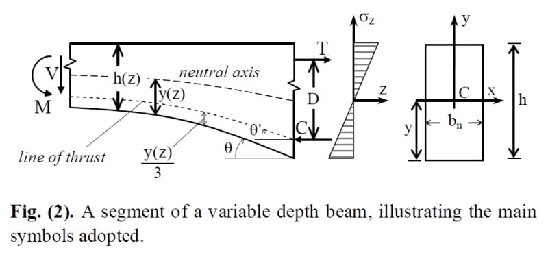

picture ware taken from research paper Link
The problem was asked by third person whose beam has different geometry (also variable depth beam). Iam trying to study (develop if possible) the shear reinforcement spacing formula (theory derivations) for such conditions (variable depth and loading).
and again, I highly admire your help and patience ...

Eurocode clause 6.2.1 adds an extra shear component for inclined chords. Figure 6.2 shows it.
