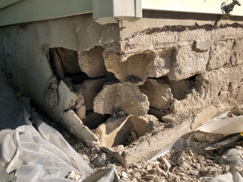

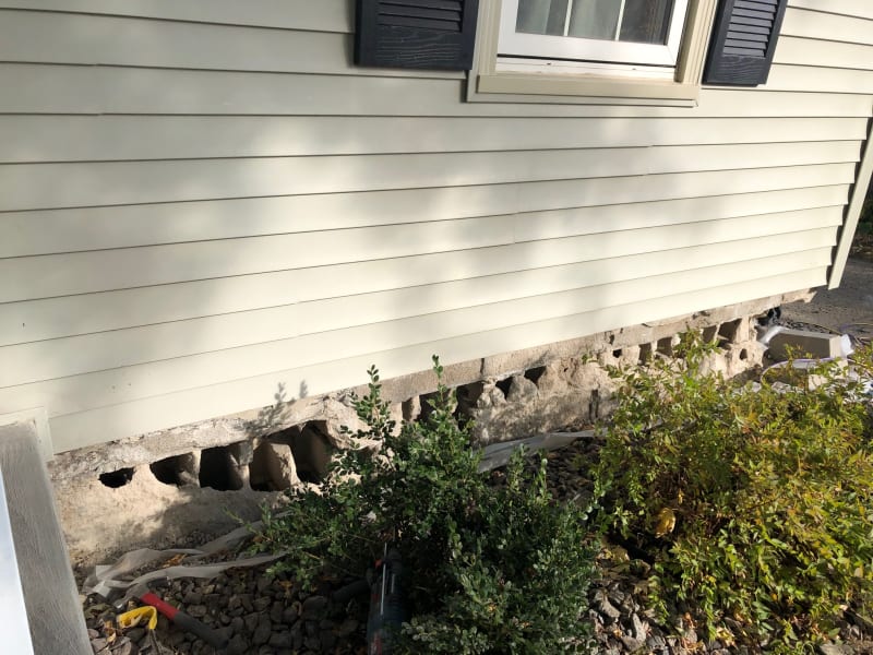

Hi all. I've been redoing the parge coat on my foundation. The existing parge coat is cracked and has two old layers - the top contains rusted lath. It was also applied too thick (1.5-2.5"). Anyways, when removed from this one part of the house I discovered the blocks are in rough shape. I'm looking for a way to reinforce and build up the voided areas to stabilize the wall.
Excavating/rebuilding is not an option at this point. I've talked to a few contractors and am unsure of what to do as they proposed different options and am not an experienced mason by any means. I'd rather fix this myself, but don't want to do it in a manner that is not structurally safe or needs to be removed in the future. The blocks appear to be in decent shape below grade, although the mortar seems to be lacking in spots.
My question is - is there a way I can pour concrete into the above grade only section of the foundation? The wall is roughly 9' tall from the footings and about 20" is above grade. If this is an option that doesn't compromise the below grade structure, what is the best way to block the cavities and fill? What would you recommend adding for new rebar or steel reinforcement as far as placement and installation?
