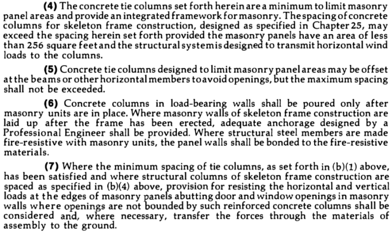

The FBC does not do a very good job of explaining the intent (rather history) behind these two sections. Section 2121 is a detailing residual that is left over from the South Florida Building Code. If you follow section 2121, you're essentially providing CMU infill that is considered non-load bearing for the purpose of gravity loads. The only reinforcing requirement specified here for the actual CMU is the horizontal joint reinforcement that is to be embedded in each tie-column. This was/is viewed as a concrete frame where the CMU was analogous to a curtain that was placed within the opening.
Here are some images from the 1984 South Florida Building Code:
Per Section 2703 ALLOWABLE UNIT STRESSES IN MASONRY:
Regarding tie-beam:
You'll notice that some of this language closely follows section 2121 of the current 2023 FBC.
This is all to say that, no you're not required to have this 16'x16' grid of cast-in-place tie-beams and tie-columns so long as you design your CMU per TMS402/602. CMU bond beams can be used.
