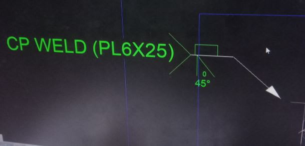

Hey guys, I have the case which is no root opening for single bevel groove weld, is it acceptable? My detailer didn't provide any cut for root opening.

Is this a detail for plate repair?
If AWS were the governing code it would not be a pre-qualified weld, and a WPS would be needed.
Is the plate only 1/4" thick? Some options would be to grind the bevel out to an acceptable root opening, or grind to a square butt weld.
In lieu of altering the root opening, you could replace the backing bar with backgouging and re-welding the root.
From the designation of the plate I would guess it's 6mm (< 1/4"), but it's just a guess.
The "PL6x25" designation should be the backing bar size. Correct, in "mm".

Yes, you are right

In lieu of altering the root opening, you could replace the backing bar with back gouging and re-welding the root.
Yes okay, so we generally need root opening? or doesn't it matter?

For pre-qualified CP weld, yes, I believe. See the linked PDF, Fig. 2.4, on p26.

For V-Groove weld, can the angle be 90°?
Thanks in advance!!
Yes. See previously linked paper for details.
