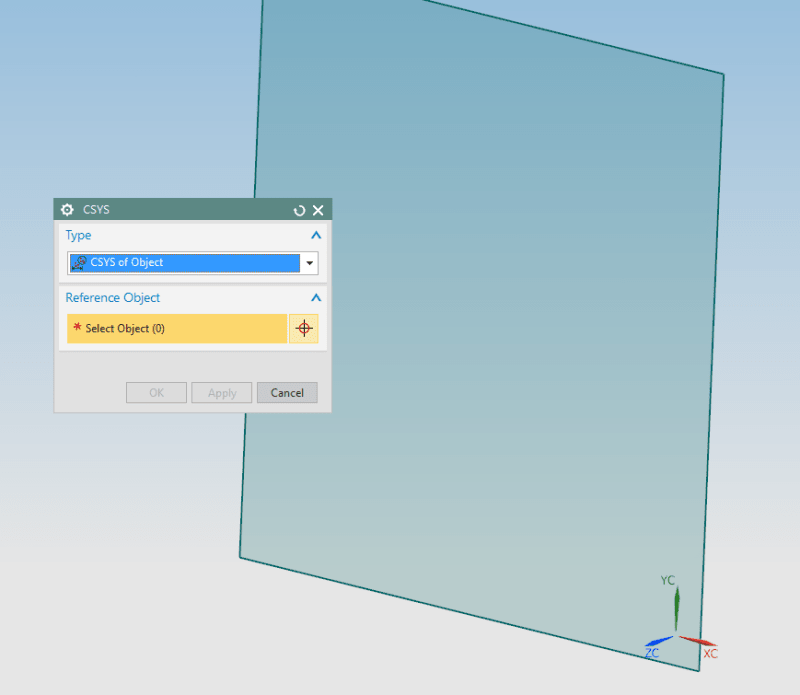

I want to draw a circle on a Datum Plane.
I have the datum plane and I have the co-ordinates of the center point of circle.
I recorded the macro and every time I use a different model and the methods used in the recorded joutnals are different every time. That's what has got me confused.
How can I create the 'direction' of circle and hence the orientation of the sketch? For creating the direction of the direction of circle you need origin and a vector. What vector is that and how can I obtain it from the plane. Can I obtain this vector from the 'Normal' of the datum plane?
I think what will work out for you here is before you create your circle, place and orient your WCS onto the plane,
You will then be able to use the x-axis or y-axis of the WCS as your direction.
Format -> WCS -> Orient -> CSYS of Object -> select datum plane

The GTAC example: nx_api5931 shows one way of getting the orientation matrix of a datum plane.
