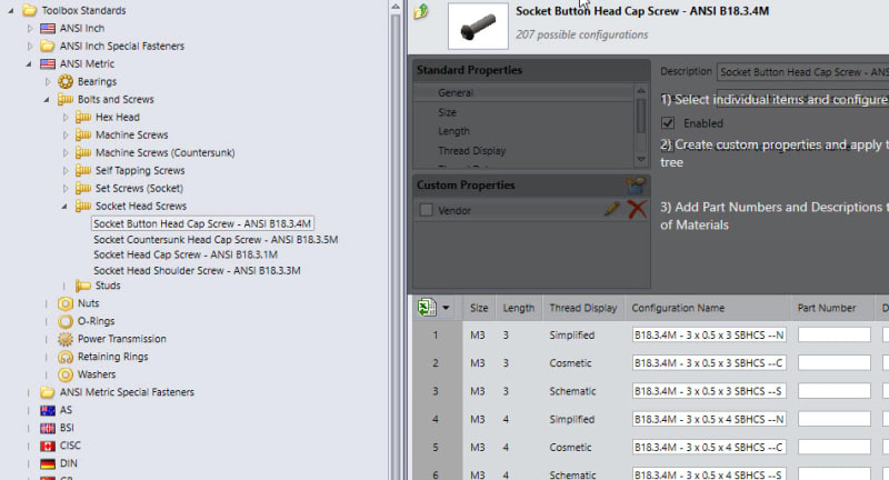

in our toolbox parts of shc screws we have 2 of each item such as an m6 x 20 long - one has a chx extension & the other has a nhx extension after the part name - would like to know what this is and why we have double the parts except for this extension - thank you
Sounds like its something that someone made custom, not something that is in the default Toolbox, at least not in mine. Granted I don't use TB at all, because I made all my own fasteners with controlled Design tables.
The only thing I can think of is your admin changed the "C" to "CHX" to mean "Cosmetic" and "N" to "NHX" to mean "Simplified".
