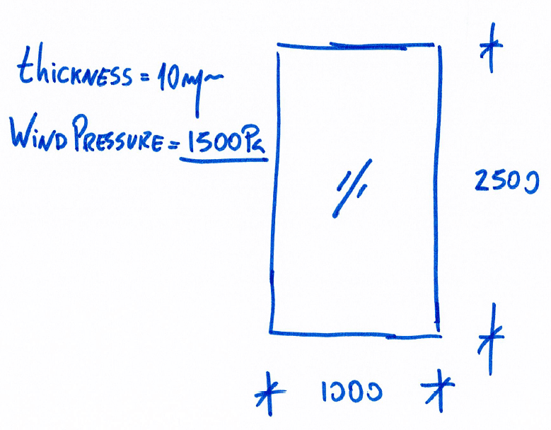

Hello!
I'm having some troubles, and I really don't know if i'm over complicating. Hopefully some of you will be able to help me.
I'm currently trying to prepare some hand formulas to put on my excel sheet to evaluate the chord shortening of a glass panel when subjected to wind pressure.
I'm able to find the deflection (δ on the scheme bellow) on the pane and I would like to backward evaluate the Δh (vertical displacement) in order to ensure the glass ply doesn't slip out of the framework.

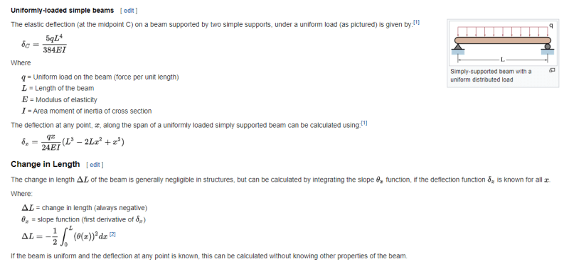

See if this helps (excerpted from Wikipedia).

@retired13 with the change in length formular for beams, considering a beam with a 1000 mm x 10mm (I=8.33 cm4) and L=2500mm i got a delta L of -17.016 mm.
@jjl317 the results from FEA are just to confirm my method. The FEA model consist on a 1000x2500 mm glass sheet with a thickness of 10mm subjected to a wind pressure of 1500 Pa (N/m2).
@rb1957 the software i'm using uses a geometrically non-linear analysis, so i believe there's some kind of membrane forces. But for my excel sheet I prefer to have it doing linear analysis as it is more conservative. Do you have any scheme of your method?

@jjl317 the FEA results I presented on the pictures above are merely representative. Please don't focus on the 126 mm deflection perpendicular to the glass or stress.
I'm just trying to find a way on how to calculate the vertical displacement of a glass panel when subjected to wind pressure. The glass panel is considered simply supported on the top and bottom (As shown on my first scheme).
So far, with the method @retired13 mentioned for beam deflections I manage to get 17.016 mm, that is a little off the 15.73 mm I got on FEA.
This difference gets worst whit the increase of the Panel Height (L).
Any help is much appreciated.

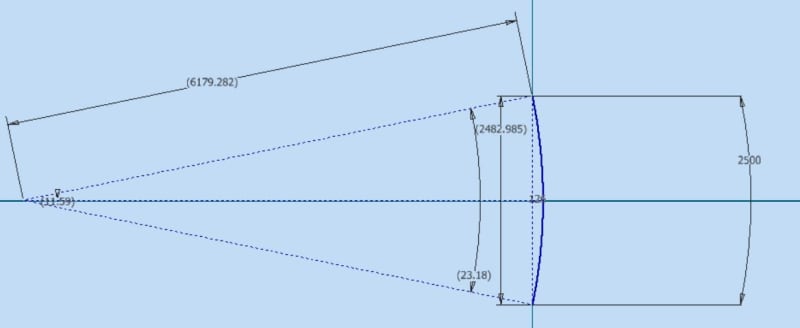

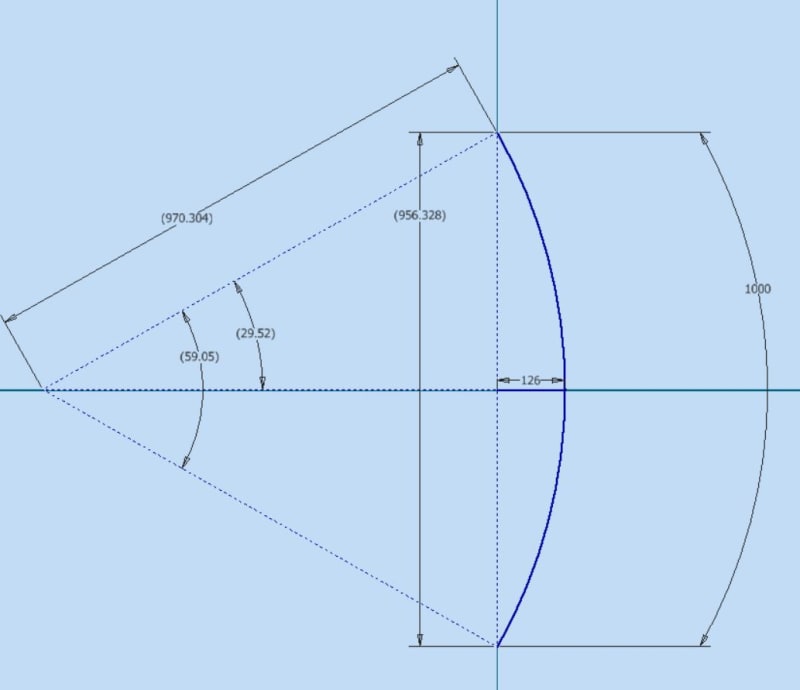

@GoncaloPT Could you please post the span dimension (length) so that we can test the geometric method that @rb1957 suggested? This could also be figured in cad. Here I've used the deflection of 126mm with an assumed span (arc length) of 1000mm arbitrarily.
The geometry shown on the FEA results is the following
@GoncaloPT ok, so using the 2500 mm with the bending deflection of 126 mm and the geometry of the chord of a circle, I get a "shortening" of 17.015 mm.

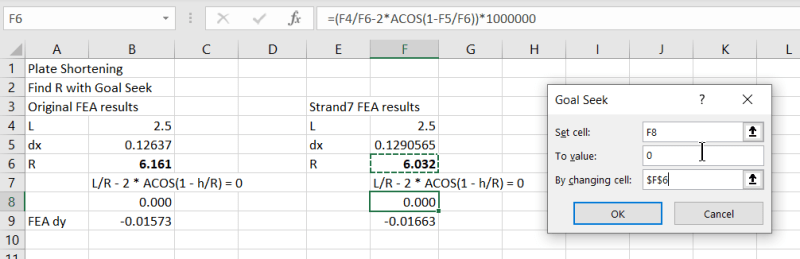

I'm having some troubles finding the geomtrical solutions via Excel
The formula I need to solve is the following
I need to find the "R" value for a given "L" and "h". I'm trying to set this with the solver functionality in Excel but i'm not getting it.
Does anyone know how to work this out?

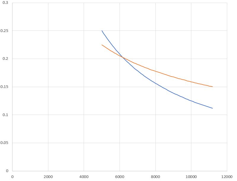

@rb1957 ah I see, the guess and check method. Thank you, that should have been obvious. Another option (essentially doing the same thing) is to plot the two equations over some reasonable range of R values in excel and find the intercept. Both equations will trend towards zero as R increases.
excel "goalseek" may help (I haven't used it, but it sounds about right).
graphing is a good way to find trial estimates.

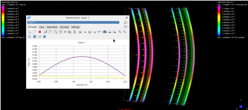

In response to GoncaloPT, the screenshot below shows the use of Goal Seek to solve the equation: L/R - 2 * ACOS(1 - h/R) = 0
Goal Seek is now under What-if analysis on the Data tab. The "Set cell" needs to be a formula that refers to the "by changing cell", which must be a numerical value, not a formula. I have shown results for a dx of 0.12637 from the original FEA, and 0.12906 from a beam analysis I did myself using Strand7.

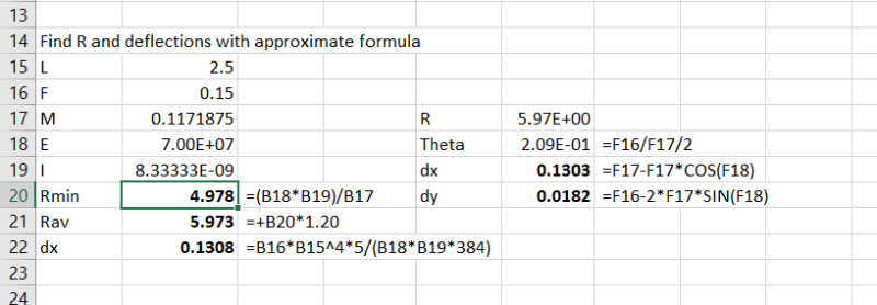

A simpler way, which given the uncertainties in the applied load I think is accurate enough, is to calculate the radius at mid-span (using 1/R = M/EI), then factor that to get an effective average radius over the full length, which allows both the horizontal deflection and the shortening to be calculated quite simply:
Based on my own analyses, I found a factor of 1.2 worked well, which gives a dx of 0.1303 and a dy of 0.0182.
I also looked at using a beam FEA, compared with plates. I also looked at the effect of subdividing the beam into 2, 16, or 64 elements and plates with 16 or 64 4-node elements or 64 8-node elements. The 2-element beam gave almost 20% less vertical deflection, but all the other results were virtually identical, with the analyses with more elements giving marginally more vertical deflection:
My vertical deflections are about 1mm greater than those in the OP analysis. Possibly a reason for this is restraint of the top and bottom nodes in the Z direction, which stiffens the plate in bending (and doesn't happen in the real structure).
