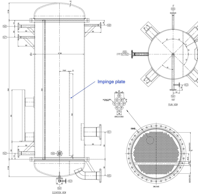

- Common inlet gas header with x2 inlet nozzles to exchanger
- x2 pass exchanger with 75% tubes for 1st pass & 25% tubes for 2nd pass (I dont know the reason)
- In the shell there is an impingement plate before feed Cl2 nozzles
Strange design

My guess is you have a F shell here - the longitudinal baffle is offset with 25% tubes on one side and 75% tubes on the other side. While the chilled water is a somewhat odd 2 pass setup on the tube side with the same split in the number of tubes (25% on one pass and 75% on the return pass - since I dont see any other pass partition divider on the tube sheet). This may bring up differential thermal expansion concerns if there is a significant operating or design temp difference between the 2 sides.
On the chlorine shell side, the narrower section handles the smaller desuperheating duty, while the wider section provides the larger condensing duty

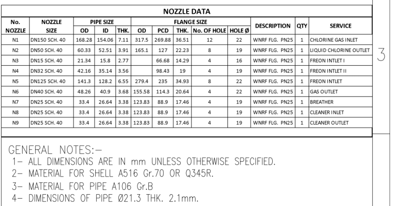

Very helpful comments. I am attaching another design image & its similar. However in the previous design the impinge plate in front of feed Cl2 nozzle is extended all the way down to tubesheet while here there is 30mm clearance. Mind it that Cl2 gas generally has Na2SO4 amounts which in time (5 years lifespan of CS liquifier) foul shell side.
According to you having this clearance is better or not?

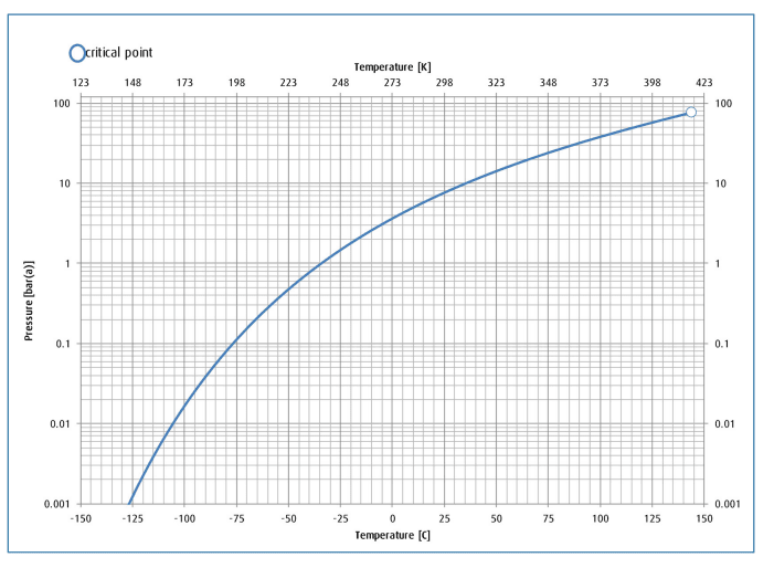

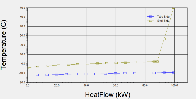

I am also attaching heat duty curve (via UNISIM simulation) for Cl2 @3bar 60C ~1.2ton/hr feed to Liquifier (from a compressor). As you can see it changes phase at about 2.5C. From this curve one can observe difference in condensing & sensible duty
What I perceived to be an F shell baffle isnt actually so - this baffle only extends partway up the shell, so I cannot tell what this divider plate is doing. And you have marked it as an impingement plate. But that cannot be the case - the impingement plate is shown immediately next to the N1 nozzle.
The 30mm clearance gap between this divider plate is required: it is meant to allow any chlorine liquid that may have condensed in this desuperheating section to dribble out into the other side of this divider which leads into the N2 liquid chlorine outlet. Without this clearance, the desuperheating section will completely flood up with liquid chlorine.
Ok, from the heat curve, we can see chlorine condensing temp is about 0degC - so shellside operating pressure = 3.5bar abs approx.
