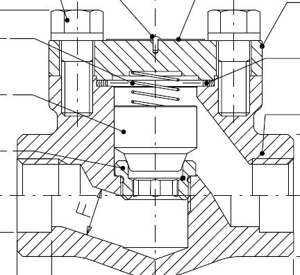

There is a Check Valve installed in the discharge side of the reciprocating pump in the Chemical Injection Package. Working and Stand-by Pumps are connected to common header. During FAT of the packages, when testing the scenario of switching from Working (Pump A) to Stand-by pump (Pump B), we noticed a reverse flow passing through the Check valve of the (Pump A). Back Pressure is created through Regulator for testing.
Check Valve Type - SW 800 Pound rating Lift Type. (All are SW piping circuit)
Discharge pressure of the Pump is 65 PSig.
Valve vendor responded as below
"Quote : "Vendor tested this valves according to the applicable pressure class (800) that mean 150 bar...The main problem is that you are using this 800 class valves for a different purpose. The sealing surfaces design for a class 800 (150 bar) is different than a sealing surfaces design for 4.48 bar (65 PSI). If you need valves for low pressure you need to order a different design"

IMO, the piston of the check valve might be stuck which resulted in the reverse flow.
May consider to use a spring loaded check valve.

The Check valve installed is spring loaded lift type Check.
Just want to know, whether responses given by vendor is valid in this case. Check valve to function in case of any amount of pressure in case of reverse.

Virtually all check valves will pass fluid in a reverse direction and are not normally required or can seal tight. So yes the valve might pass a bit and presumably pressure up the piping downstream the pump but so what? Check valves are there to stop large scale flows. Many HAZOPS will allow for 10% of max flow to go back through a check valve.
SO my guess is that at the pressure rating they are looking at, you've got hard metal seats which have a very small pressure differential on them and hence are not sealing 100%.
For a lower pressure rating you might get soft seat valves which are more able to seal.
Either way complete reliance on a check valve to seal off pipes is poor practice and often fails!

Reverse flow noticed through the Pressure gauge deflection, when switching over the pumps for testing pressure.
My interpretation is that, there is a check valve in pump itself, and small reverse flow is ok. Please correct my understanding..

Assuming the valve is not malfunctioning and is installed correctly, you may ask an applications engineer from the valve supplier to either diagnose the issue or recommend alternative seating materials.

Thanks for your expert opinion. Valve vendor suggested for a flat sealing configuration in place of conical seat for low pressure application. Also, we need to upfront inform valve vendor during selection about the pressure range for them to choose a right configuration. This is a lesson learnt.

I think you're over thinking this. Check valves will always leak in service and cannot be relied upon to seal 100%. That's what isolation valves are for.
