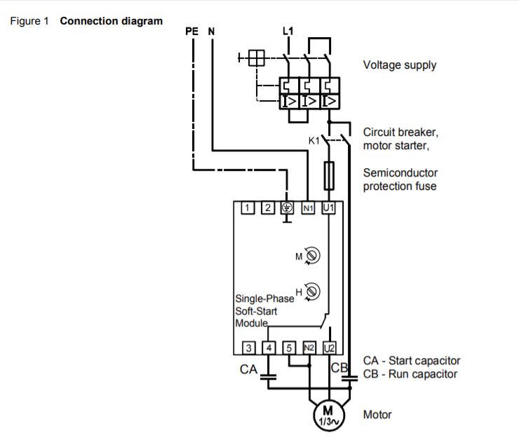

Yes, the single phase motor is more failure prone, it has the capacitor and often a centrifugal switch. But, you don't need to switch to 380V to get a 3-phase motor. Many VFD's can do single phase in and 3-phase out but then you add the VFD to the failure possibilities. Overall, I suspect a decent quality single phase motor would be more reliable than a VFD. But, if you need a LOT of starting and stopping or speed control then the VFD makes sense.

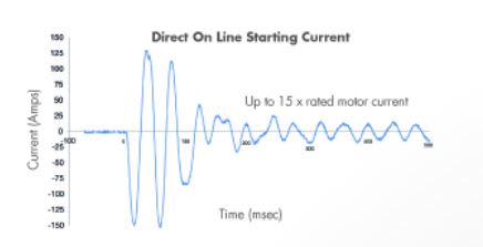

Whit that duty cycle I do understand that the motors does not last very long first you have a start current and some seconds of running which generates heat especially the start current and then only 5 seconds of cooling time.
Maybe a soft starter would help it will reduce the start current it might be enough to not overheat the motor.
Whit that duty cycle you would need a motor for S4 maybe even S5 to do the job.
