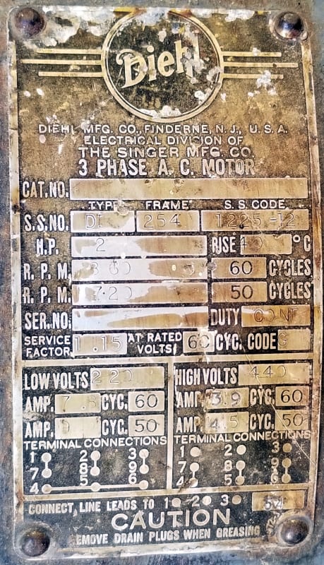

Manufactured by Diehl
Rewound for only 220v previous to my acquisition
Nameplate info (220v): 2 HP, SF 1.15, RPM 860, FLA 7.8, 3 phase

Thanks for your input, waross. I suspect the 220 volt label has to do with the manufacture date of this motor and the changes to electrical standards and nomenclature over time. I realize the RPM is unusual, which is what makes this motor so useful to me and makes it difficult to affordably replace. Just to reiterate... this motor has been rewound at some time in the past before I got it. I took it to a local motor shop to make some inquiries about it. They told me that when a shop rewinds a motor, they stick to the original specs, though whoever rewound this one didn't bother with the convention of stamping through the voltage on the nameplate that is no longer available--in this case, 440v. So, I suppose when it was rewound, it may have been done in a way that favors a voltage slightly different than 220v.
I have the VFD in perpetuity. Your suggestion of programming the VFD with a slightly different voltage is an idea that had not occurred to me; I'll try that.

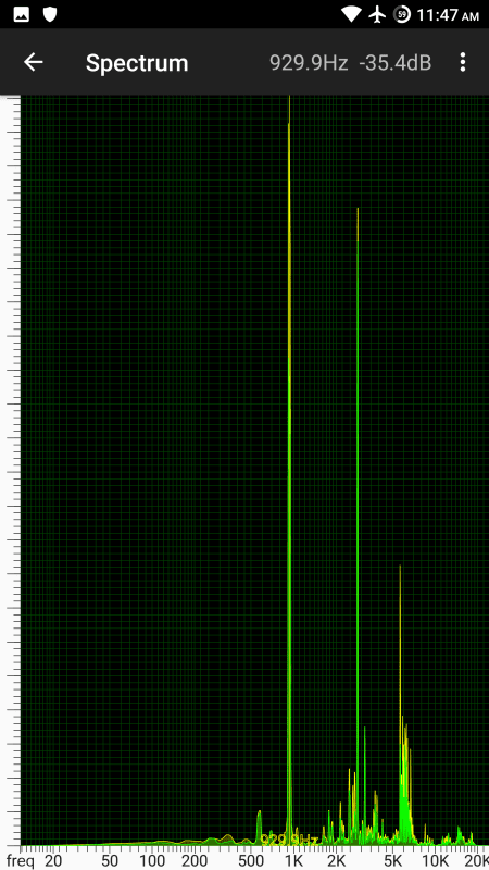

I measured the frequency of the whine while the motor was running at 60 Hz. The screenshot of that measurement is below. It showed three predominant frequencies: ~930 Hz, ~2800 Hz, and ~5600 Hz, but the frequency that sounded most dominant to my ears was the 930 Hz. None of those frequencies are exact multiples of 60 Hz. The whine frequency does go lower as I lower the motor frequency using a VFD, but it doesn't get very tolerable to human ears until a power frequency of 45 Hz or lower is used. Listen the audio recording of the motor running at 60 Hz on a VFD.

Is there a mix-up between 929 Hz and 900 RPM (15 Hz)?
The number of slots may factor in.
