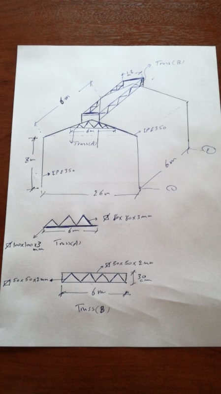

Hi
Please see the attached image:
Truss A & truss B are supporting a chain conveyor platform with capacity 100t/h-150t/h.
Are there any references for the analysis and design of such a structure? Are there any thoughts on considerations for such a structure?
Any thoughts would be appreciated.
Is this a new addition to the roof truss, or existing? In either case, you need to provide more information, a drawing of the conveyor is a good starting point; also you need to shown where the conveyor is to be placed in relationship to the roof trusts. Do you have loading/reaction from the manufacture?

All are new.

Please find the link:
The conveyor is to be placed on top of Truss B.

No.
You need to get the dead load (weight), rated static load (lift) capacity of the carriage, impact factor, deflection limit, and recommended connection detail/method. After gather all information, the design shall be straight forward - truss supporting moving load. Also, it is helpful to do some research on CMAA for add'l design considerations.
I do plenty of design work for chain conveyors. I wouldn't say it is particularly different or challenging. Work out appropriate loads from the manufactures drawings, weight of trough, chain and product.

Reaction is relatively easy to work out based on motor power AND/OR sliding friction of the product. Motor power should give you an upper limit unless the motor is a braked motor (which most are not).
In practice I would normally expect that lateral loads from the conveyore are going to be less that other loads such as wind or seismic.
Can I ask who the manufacturer of the chain conveyor is?
Thanks. Contact the supplier for head, tail, trough and chain weights. Work out product weights based on product density and volume. Go from there.

As mentioned previously the dynamic effect aren't generally considerable. The lateral loading can be calculated from the motor torque/power. In most cases nominal lateral restraints should be fine.
In some cases aka flood fed chain conveyors you can start dealing with high torque loads and high lateral loads. EG one I dealt with recently was a peak load of 65kN off a 23,000Nm motor. But that is far from the norm.
But you need to get the specs for the conveyor you are considering.
