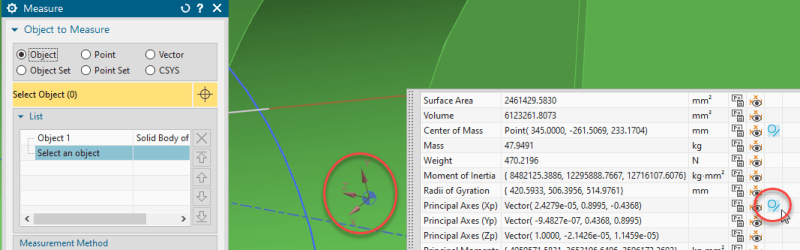

I CANT SEEM TO GET THE PRINCIPLE AXIS AT THE CG TO SHOW UP IN THE NEW NX 1919

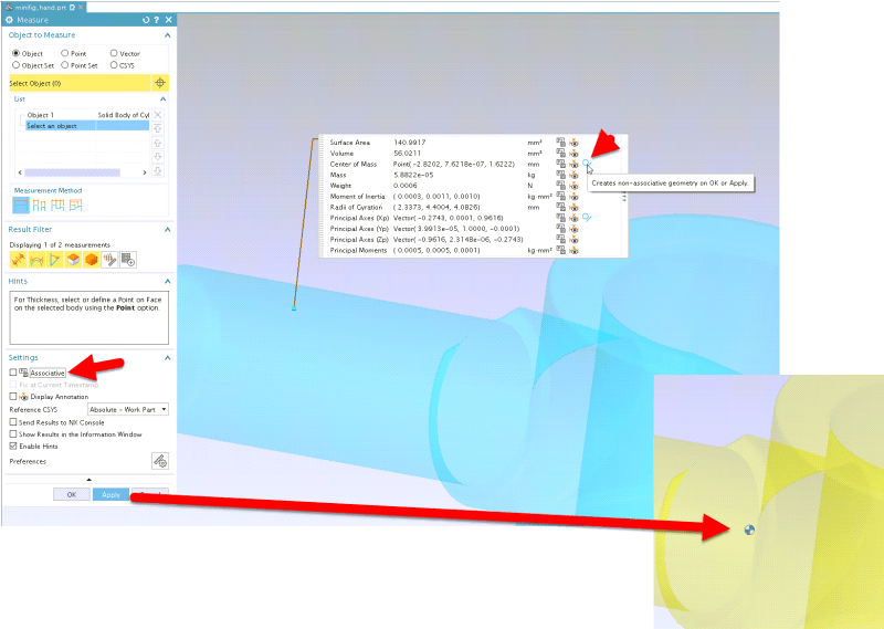

You won't get a CSYS as in the past, but you will get a datum symbol (displays as a symbol, but is a point when selected).
When you measure, expand the results dialog (click the arrows on the right of the results dialog).
You can then click the icon on the Center of Mass line, to create the symbol.
It will be associative or not depending on the setting on the measure dialog.
Hopefully image below explains it better than I've written it.

I think it should create the principal axis and the CG as Anthony describes if you tick the Principal axis option.
This is NX 1934 :
