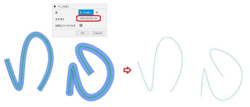

Autodesk's Fusion360 (like a CATIA macro) that measures and creates centerlines for pipes and harnesses.
Link
Please feel free to use it if you have any use for it. Originally, it was requested by a Japanese user, so it only displays in Japanese, but it can be modified to display in other languages as well.
Fusion360 does not allow import/export of curves, but we have created an add-in for that purpose.
Link
I think it is possible to create a centerline using the same algorithm, but since CATIA's macros do not expose as much functionality as the Fusion360 API, I do not think it is possible to create a centerline in the same way.

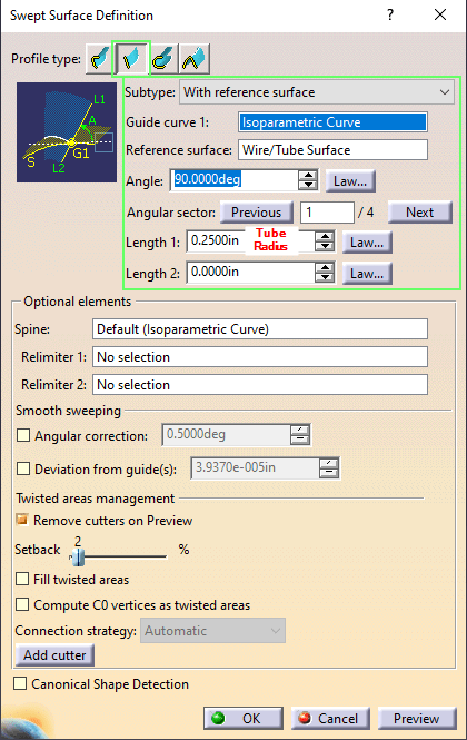

1. 'Extract' the outside surface of the wire/tube.
2. Create an 'Isoparametric curve' that runs along the length of the surface (this operation can be found nested under the 'Spline' operation on the 'Wireframe' toolbar).
3. Create a 'Sweep' using the following settings:
Profile type: Line​
Subtype: With reference surface​
Guide curve 1: Isoparametric curve from step 2​
Reference surface: Extracted surface from step 1​
Angle: 90°​
Length1: The radius of your wire/tube​
4. 'Extract' the edge of the sweep that is at the center of your tube/wire.
5. Complete! Measure your CL.
