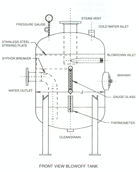

Does the tank have an internal, stainless steel "striker plate" ?
The striker plate is meant to be the sacrificial target for the blowdown and usually runs 270 degrees around the inside of the tank. Welded on all four edges .... The plate thickness is typically the same as the tank wall.
This is a very common feature for boiler blowdown/blowoff tanks .... I have specified many tanks with this feature

And are mandatory in Canada for tangential nozzles, per CSA B51 (7.5.3.6), although it doesn't require stainless.
The tank construction is much the same as you assume. 3/8" carbon tank shell, but only a 3/32" 304-SS circumferential liner (360degree in this case). Our problem originally was that we blew right through it in 7 months. My original assumption was that the nozzle velocity was too high. Indeed, the flowmeter data we have indicates that we were blowing down at a rate at least double what the tank was spec'd for. This seems to be due to a change in goals (blowdown tank was originally to lower silica, but the lab blows down more in order to limit conductivity, which appears to be a harder target to meet).

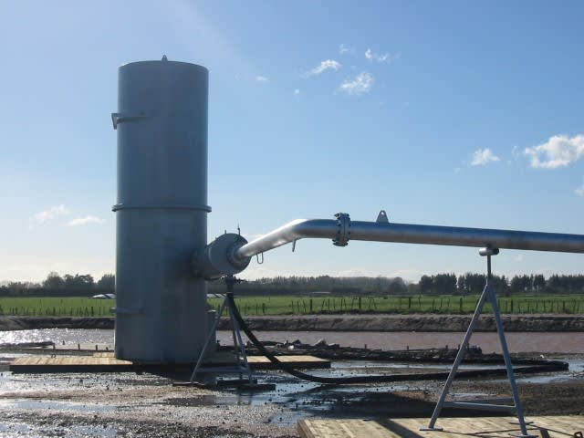

In our applications (much larger flow) we limit the steam phase velocity to around 100m/s in the pipe between the valve and tank. The pipe is also quite long, 12 diameters or more. We still get some wear at the tank inlet and make this section thicker.

KevinNZ, do you happen to know what steam quality you flash to in the vessel? That might give me some idea.
Hi Carzypeters
The setup in the photo is used for steam mass fractions from 15 to 50%.
