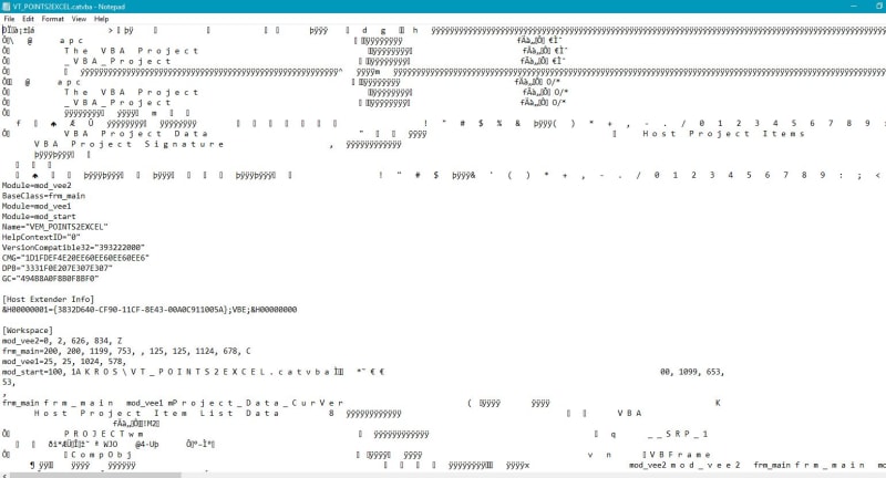

I'm trying to run a .catvba file that a coworker from Germany wrote but I can't seem to get it to show up in the "available macros" list as shown in the image below with the blue question mark.

This file is a VBA script, when I use notepad to edit/view it the file is not readable see attached image

Thanks for uploading. I am able to observe list of modules and run the one named mod_start.
What CATIA version do you use?
Meanwhile it seems that .catvba contain nothing but two subroutines and a form that runs them. I've extracted them as CATScripts so that you can run them without VBA.
