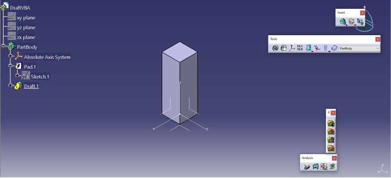

Hello All.
I am trying to draft this pad using VBA, i recorded the macro for draft but i am not getting some part of it and i want to know how to select faces in a PAD feature and create Draft
here is the recorded code that i am not understanding the reference 20,21,22,23

I am not understanding the CREATEFROMREFERENCE() Part
Dim reference20 As Reference
Set reference20 = part1.CreateReferenceFromBRepName("RSur:(Face:(Brp:(Pad.1;0:(Brp:(Sketch.1;10)));None:();Cf11:());WithTemporaryBody;WithoutBuildError;WithSelectingFeatureSupport;MFBRepVersion_CXR15)", pad1)
draftDomain1.AddFaceToDraft reference20
Dim reference21 As Reference
Set reference21 = part1.CreateReferenceFromBRepName("RSur:(Face:(Brp:(Pad.1;0:(Brp:(Sketch.1;9)));None:();Cf11:());WithTemporaryBody;WithoutBuildError;WithSelectingFeatureSupport;MFBRepVersion_CXR15)", pad1)

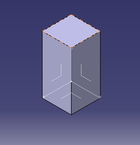

How do i make vba automatically select required faces to draft

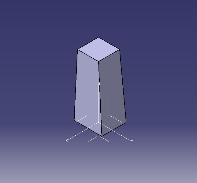

Here is the Pad that is drafted
Here is the Pad file that i want draft

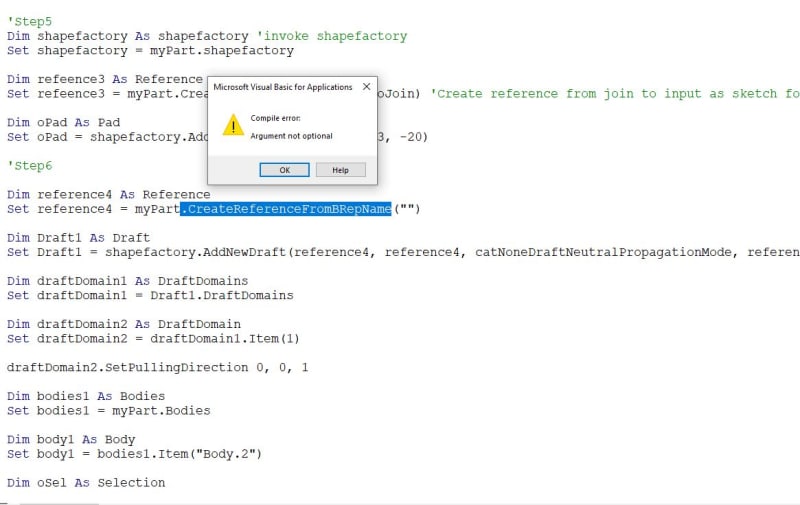

Hey Thanks for quick replay.
I followed your code but getting these errors
Hello,
don't use that BrpName for reference, go with selection for the first error.
I sent you an example for CATScript, this is some other environment as I can see.
Try to go with Dim F_body As String instead of an object.
Check this post for selection and how to go with for loop
Hey I tried Declaring F_body as string but still same error
and i cant figure out how to what to do with BrpName
here is the complete code
