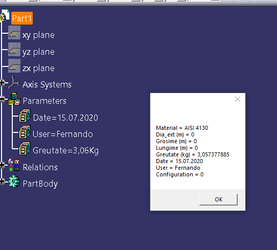

How I can read assigned material of part and print it on screen as message box?
I was trying with this script example but without success since I don't see anything when I run script.
One of possible solutions that I can see is that in part tree there is also Material parameter. Is there method in VB to get information from this parameter to read name of material?
Interesting, I wasn't able to get directly the name of the material, I never thought of this...but...

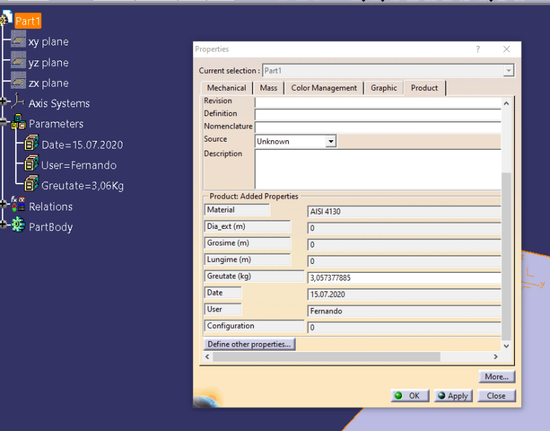

Workarounds:
1. Write a macro to put your material in user defined properties and get from there the parameter material.
1. Get your material from a customized BoM in a product.
Regards
Fernando
