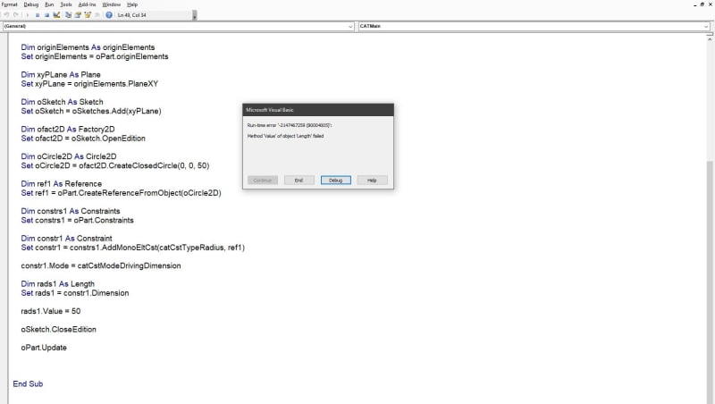

i am trying to create a cylinder using vba but iam stuck at constraining the circle
here is the error i am facing
Here is the VBScript

its just a simple macro but i am not good at constraining sketches using VBA
any one know what issue is this and what mistake i made and how to resolve it
hi, this works for me...

Dim C As Constraint
Set C = oSketch.Constraints.AddMonoEltCst(catCstTypeRadius, ref1)
C.Dimension.Value = 50
C.Mode = catCstModeDrivingDimension
Set C = oSketch.Constraints.AddBiEltCst(catCstTypeConcentricity, ref1, oSketch.AbsoluteAxis.Origin)
