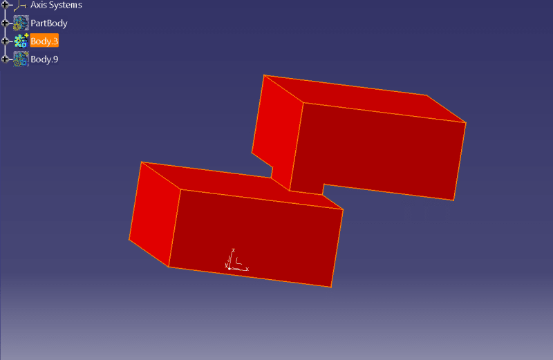

My code splits a body with a plane. What results is a body made of two pieces. I need to separate these two pieces in code but I dont know how to do this.
What I am looking to do is split the body into two bodies (in VBA) so that I can continue to work with the two pieces separately.
The way I would do this manually is to copy and paste the body and use remove lump to isolate one part and then paste and remove the other lump. The problem I am running into when trying to implement this in VBA is that in order to use "remove lump" you need to select a face and I don't know how to tell which faces are part of the first piece and which are part of the second piece using only VBA (there seems to be nothing distinguishing them as being part of one closed piece versus the other).
The first picture shows the body before the split. The second picture shows the body after it has been split. Both solid pieces are part of the same body.
thanks,
Sam
Is there any way to break apart a body into separate bodies that anyone knows about?
Does anyone have any other ideas about how to do it manually? This might be a good place to start.
Thank you for your reply! That is not exactly my problem. Let me see if I can clarify.
I start with a single body pictured in my first post.
I split the body with a plane and select the side to keep.
The result of the split looks like this (and is a single body)
I want to separate these two chunks into different bodies similar to what you would do with "remove lump", but I want to do it in VBA.
Does that help clarify?

do you need to know the history of the split? if not i.e. you are just interested in the lumps, I'd suggest moving over to GSD (surfaces). there you can use disassemble(domains) feature on your split...
and then for each disassembled (and dead) feature you just create a solid.
regards,
LWolf

Hi LWolf (and Little Cthulhu and ferdo), this is a really good answer and I got it working. Thank you!
Unfortunately, this is part of a larger macro that I have already written a lot of which would require significant reworking.
Before put in the hours to switch it over to surfaces, I want to ask one more question.
I have an idea for how to solve this problem another way, but I just need to figure out how to get a face on the body with VBA without user input, can be any face.

In case this is useful to anyone, here is the working example using LWolf's starting code
Code:
'' Extracts as surface and separates

Sam said:
Dim face1 As Face
face1 = body1.faces(1)
It's possible with Selection.Search:
Code:
Dim sel: set sel = CATIA.ActiveDocument.Selection
sel.Clear
sel.Add body
sel.Search "Topology.CGMFace,sel"
dim faces: set faces = CreateObject("System.Collections.ArrayList")
dim i: for i=1 to sel.Count
  faces.Add sel.Item(i).Value
next
By the way, I believe you don't have to switch to GSD in order to leverage LWolf's idea.
You perform an extract, disassemble and then make two sets of faces: from body and from disassemble that can be mapped together using COG measurement you mentioned. Figure out what disassembled face you want to use, find it's match among original body faces and move on with it, leaving GSD aside.
Disassemble would require WIN API... (and we might have to go explain the process again)
But if you Extract a face with propagation, the result should be the lump solid extract. So keep looping face and extract and if cog of extract already exist , then discard.
This should result in as many Extract as lump solid.
