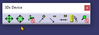

Hi Catia peeps!
Another question please. Am I supposed to be able to pan and roll with my spaceball while in a sketch? I have the toolbar and all the commands are activated and I can't move. Did I mention, I dislike Catia navigation? Really frustrating! Former NX user.
Catia de-activates the rotation mode when entering a sketch.
Needs to be re-activated in the 3dx toolbar after entering sketch.
Ok thanks rickyt. I noticed that and turned it back on but it still wouldn't rotate. Is that normal?
Do you have the 3dx driver installed or you use the 3dx built in toolbar in Catia?
If the former, you should check the options, sometimes it's locked default. If the latter, then I can't help because I despise the 3dx toolbar in the software.

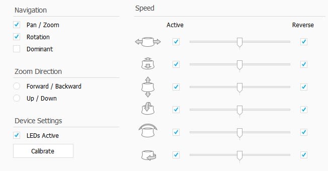

Hi Wuzhee,
I have the 3Dconnection driver installed for the spaceball. I am trying also use the 3Dx Device toolbar and I have gone into Tools, Options, Navigation and changed settings there. I've recalibrated the spaceball. It was working better on Friday but today it keeps locking up. This spaceball was just laying around the office. I've requestion a new spaceball. Hopefully that will fix the problem because I'd like to tear my hair out today. I have formal Catia next week so the Catia questions should slow down. I can't wait to feel somewhat comfortable with this CAD software!
Entering the Sketcher the 3dx tb should look like this:
And my 3dx menu for Catia looks like this:
You can zoom in out, move around, but rotation is locked. I've encountered a problem nowadays, when Alt+Tab-ing to a different window the rotation is locked in the model view. Minimizing and full screening Catia solves this, but it's frustrating several times a day.
Yes those settings match mine. I will try the full screen to minimized. Thank YOU!!!
