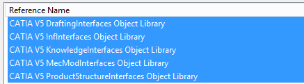

Hello All,
I have a VB.Net program uses Drafting, HybridShape and Part libraries which works fine from Catia R18 to R26. Some computers upgraded to R29 and it's now crashing in some drafting methods. It gives an exception as in the attachment snapshot. Problem happen first at myView.Activate(). If I disable this line, then it also crashes at myView.Tables.Add()
Code works fine when I try as CatScript or VBA macro in R29 but crashes with VB.NET. Is there anyone can help me about this problem?

It runs perfectly for me. No errors. R29 GA.
References in the image attached.
Calin

Hi.
Remove all references and recreate them using tlb files located in R29 code\bin directory.
Hi All,
I followed your advices and simply replaced the references with the ones coming with R29. This solves the problem for users have R29 but now it fails on previous versions of CATIA. So what understand is, even CATIA doesn't mention any change in V5Automation.chm file for some methods we use, there are somethings changing (maybe the order of calling methods), so old references do not work.
I want my code to be universal for CATIA, so someone out of the forum advised me using late binding instead of early binding for version independency. This is much reliable than using CATIA references, at least it solved my version problem in DRAFTING methods, now it's working fine from CATIA R18 to R29 with late binding.

Hi.
That's a bad advice in a long term. You want to leverage type control features of C# which is not possible with late-binding. And it's actually good that you've faced errors in the early stages and didn't mess things up more.
As a general rule, you have to generate CATIA interop libraries (from .tlb) yourself with tlbimp.exe for each release. And yes, you will have two versions of your app, each with it's own set of libraries.
It's definitely manageable and the right way to go to maintain RELIABLE applications.
