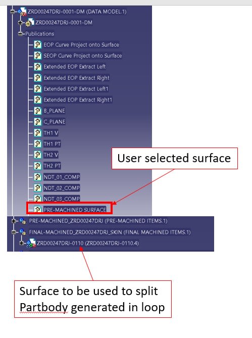

Hi, Im after some advice whether its possible to create a macro in Catia V5 to take a product with a number of .catparts, those catparts have a partbody that are published. I want the macro to be able to generate a new catpart in a different product and within that new .catpart have the published partbody link from the other .catpart from the other product. See Image with this post. So from the list Item 0010 would become 0110 with the published Partbody from 0010.
Any advice is welcome... Thanks.

Amazing! Thanks for the response weagan22 much appreciated. Ive tried to run the macro and it creates the first catpart in the 2nd product and publishes the partbody as i want, but then it seems to get stuck from there, like it doesn't know how to add the next number. Is the intended coding to work down the list of catparts in the first product and create one in the 2nd with a published partbody?
Yes, the intent is that for every part in the masterProd0010 (the first selected product) an accompanying part is created in the newProd0110 (the second selected product). Sorry, I didn't look at your part numbering scheme closely enough. This error is being caused because it it trying to create another part with the exact same part number "ZRD00247DRJ-0110" when the next one should be "ZRD00247DRJ-0111".

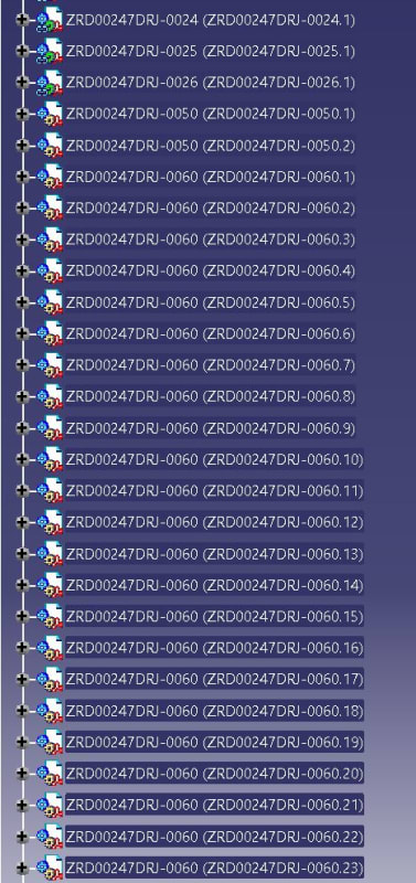

It works beautifully. The final problem I have is that within the first product ive got multiple instances of the same part. Therefore when it tries to create 50.1 to 150 it works but then 50.2 to 151 it falls over because it sees there's already a 150 been created. As you been amazing so far. my part numbering goes as follows. Items 0010 to 0030 becomes 0110 to 0130 in Product 2. Items 0050 becomes 150, 151, 152 depending on the no. of instances. Item 0060 becomes 0160, 161, 162, 163 etc depending on number of instances. Item 0070 becomes 0300,0301 etc depending on istances, Item 0080 becomes 0350, 0351 etc. Is it possible for it to recognise those numbers and if for instance there wasn't a 0070 in product 1 it ignores that code command.
Hi, Im still having trouble with the macro falling over because of my catparts having the same Item number, is there a way to identify the Instances of the item number and add it to the item number so that it can see them as seperate catparts when running the macro?

There's one final addition im trying to maybe add to the above script and that is for every newly created Part, I want to split the partbody with an external reference surface that is held in my data model catpart(surface is published). Ive read a few articles saying that I would need to PasteSpecial "CATPrtResult" the surface into each newly created part and then use the reference to then create the split.
Here's some of the code im trying to add to the other script. It seems to fall over at the user selection stage,
Dim shapeFactory1 As Factory
Set shapeFactory1 = newPart.ShapeFactory
'Trying to use the user selected surface?'
Dim reference1 As Reference
Set reference1 = uSel.Item(3).Value
Dim split1 As Split
Set split1 = shapeFactory1.AddNewSplit(reference1, catPositiveSide)
Dim hybridBodies1 As HybridBodies
Set hybridBodies1 = newPart.HybridBodies
Dim hybridBody1 As HybridBody
Set hybridBody1 = hybridBodies1.Item("External References")
Dim hybridShapes1 As HybridShapes
Set hybridShapes1 = hybridBody1.HybridShapes
Dim hybridShapeSurfaceExplicit1 As HybridShape
Set hybridShapeSurfaceExplicit1 = hybridShapes1.Item("PRE-MACHINED SURFACE")
Dim reference2 As Reference
Set reference2 = newPart.CreateReferenceFromObject(hybridShapeSurfaceExplicit1)
split1.Surface = reference2
split1.SplitSide = 1
newPart.Update
