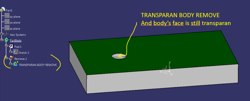

Hello everyone,
I have a problem if anybody knows solution?

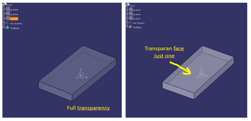

I have a solid body(catpart) It has some transparent faces and when I want to check my project with sectioning(product) that part has faces transparent it's inside seems empty not a full body. I am finding transparent faces and I am making that %100 transparent. Seems body inside full anymore.
Is there any way to find easyly where is transparent on my body? (I am looking eveywhere to find) For example catia search command. I tried but I have cound't do it yet.
Best regards.
Mesut

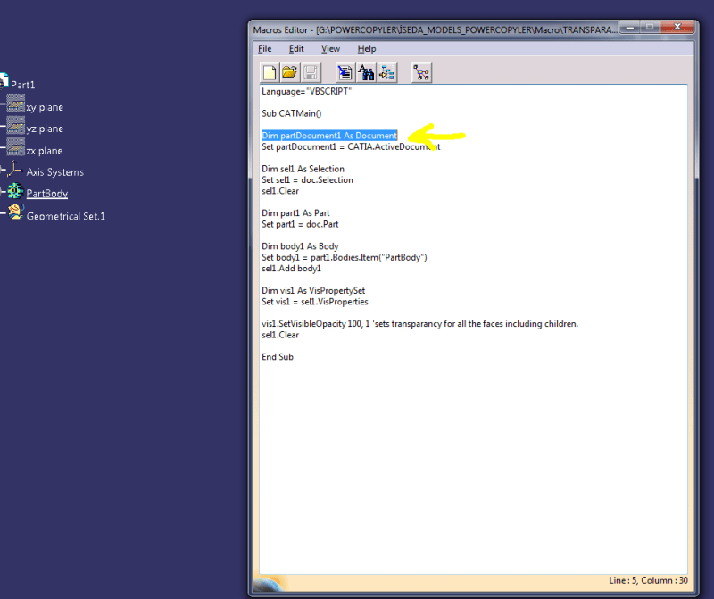

İt is not going down. Stopping at first line. What I must do?
Thank you very much.
Copy the code in a notepad and save as to ".CATScript" extension and run it or create a vba project and add this code in a module.

It worked. But it makes full transparan my part. I want it has a face and make it full opacity.
