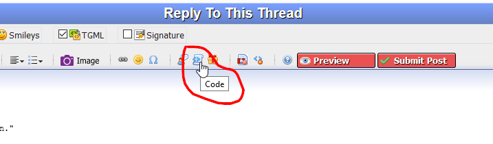

Sorry I don't see how to add in the code box like you guys have been doing.

oDrwDoc.Sheets.item(1).Activate will return you to sheet 1, just put that at the end after the loop. If you want it to be which ever random sheet was being viewed, that will be tricky.
2021-04-26_13_07_29-CATIA_V5_automation_help_and_resources_-_DASSAULT__CATIA_products_-_Eng-Tips_M_op5d3k.png
