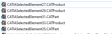

I'm have an error here:
please check your V5Automation.chm file in your [CATIA install path]code/bin folder. and read about SelectedElement and LeafProduct... that could help you understand how to make it work.
Eric N.
I have read this document, but it has not become clearer.
Moreover, it saves not with the names of the product / desk, but with the names CATIASelectedElement27 and etc.
