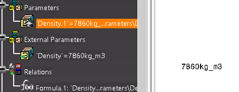

Try approaching it this way so we can help you troubleshoot the code as you write it;
[ul]
[li]Start in the destination drawing so you can identify it in the code. It is possible to have the user select a drawing view in order to find the associated 3D file. You should be able to skip the user interaction and find it directly with code if you want that.[/li]
[li]Create a new parameter with external link to the target 3D file and attribute of whatever bodies you target.[/li]
[li]Create the textbox with an attribute link to the external parameter in your drawing specification tree. (I see InsertVariable() available for linking the textbox)[/li]
[/ul]
If you have a material applied as you say, you should be able to just InertiaMeasure the Mass directly rather than do an additional calculation in the code.
