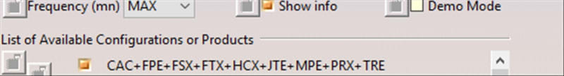

I believe that I do not have the license for "Product Data Filtering".
What's its abbreviation to look for (under Options>General>Sharable Products/Licensing)?
CAD 2015
CAD2015,
I am not sure which licensing it is attached to.
I use the CATMSE bundle which looks like:
It is not a shareable that I grab for this option.

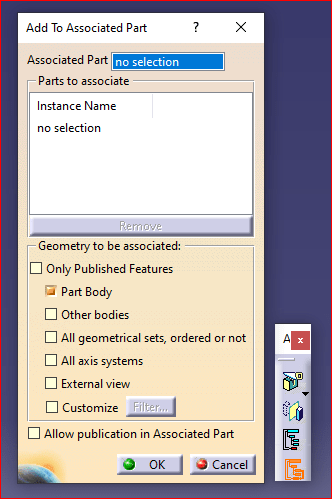

The simplest solution i found was to use the command "Associativity" or "Add to Associated Part" in Assembly Design workbench.
Both commands do basically the same, they copy with link the types of geometry you select from all parts in a product into a single CATPart.
After i run the command, i usually isolate the resulting CATPart and that's it.

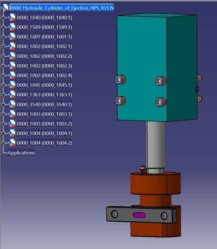

An example of what I'm getting in R28.
This is the step file I'm opening.

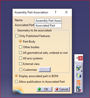

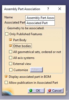

The settings in "Assembly Part Association" command. Just select the types of geometry you want to keep.
The resulting CATPart. As you can see all the colors are kept.
Hope this helps in some way.

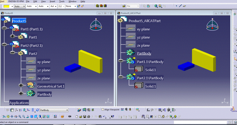

I have been through this issue as well, I found that it just depends on how the product is actually colored.
If the color was applied at assembly, or to the part body it worked correctly, but if the color was applied to each face of the part, then the AllCatPart function did not translate the color.
I would use the same "Dummy" Catproduct on each computer to verify they do yield different results.
